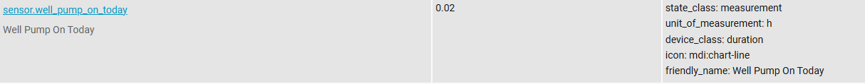

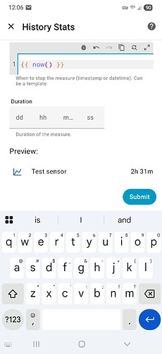

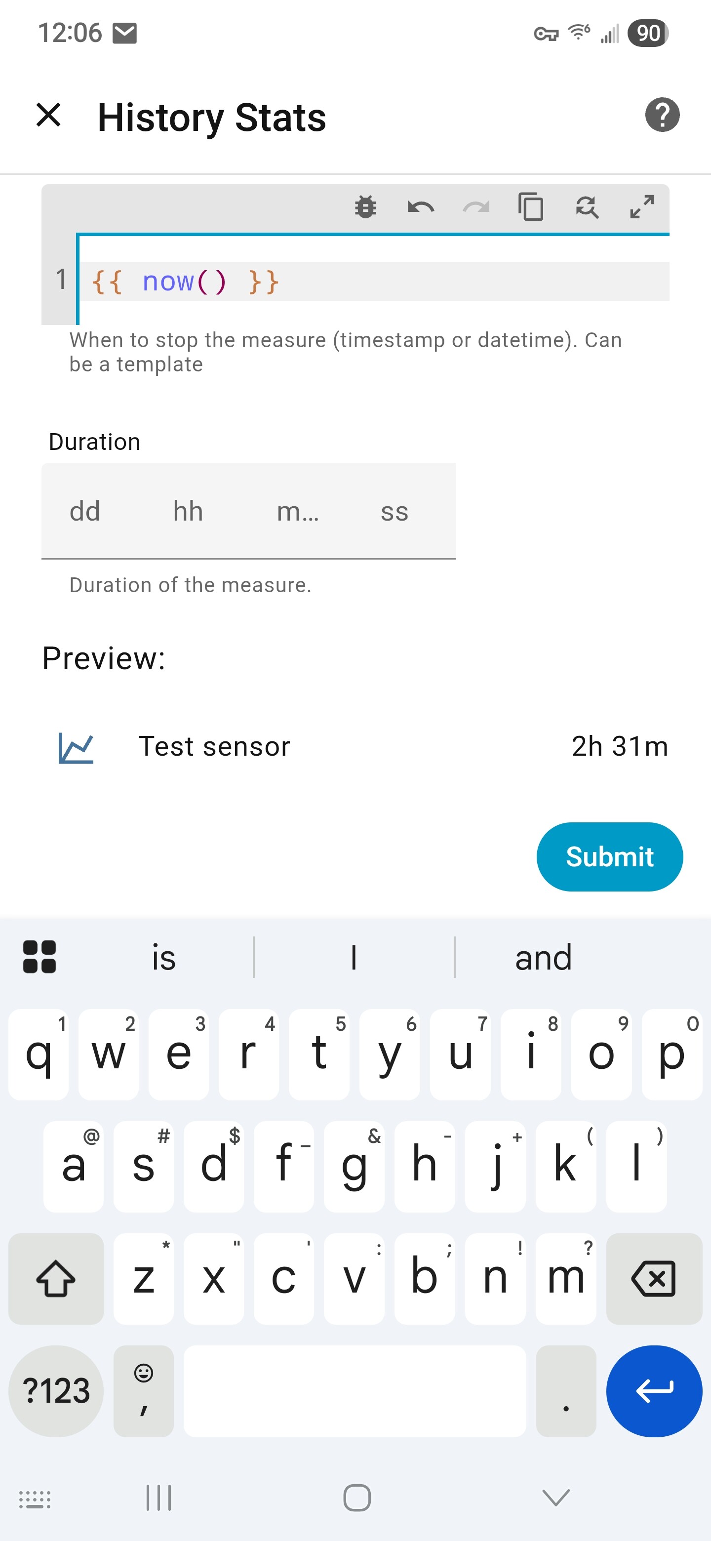

This is a new ‘helper’ history template sensor that I set up. Note the preview section.
When the sensor is place on a Lovelace card the value appears as a decimal value, not the h:m as shown in the preview.

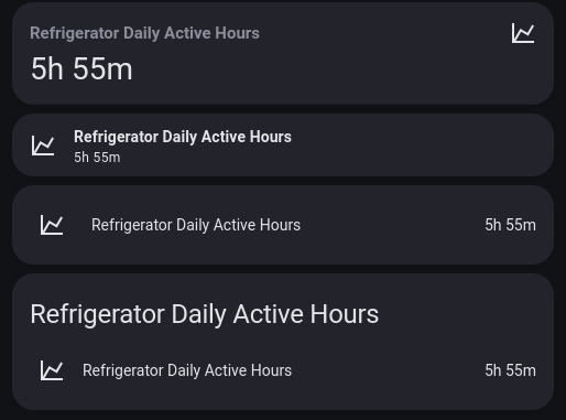

What card are you using? All the ones I tested show the value just like in the preview…
This is how all device_class: duration sensors work. The raw value itself is decimal, but it displays in frontend in a human friendly format.
