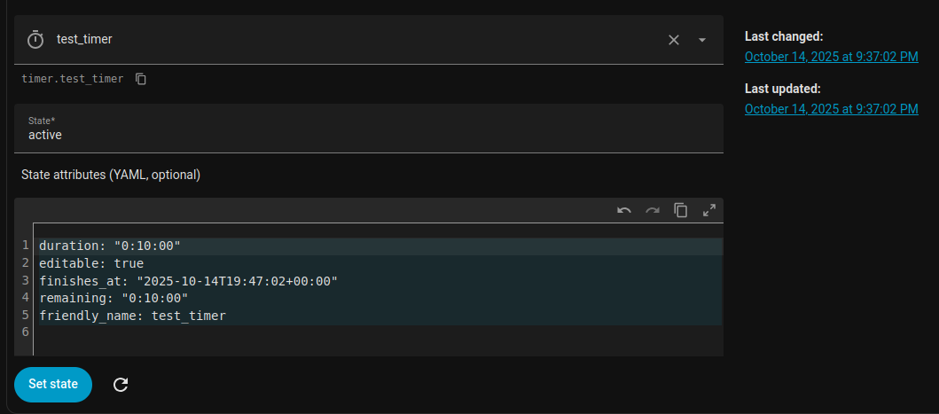

When I create a timer via a helper and start it, the remaining-var value doesn’t count down. This causes the value in the type: custom:button-card label to not count down.
Is this a bug, or is there another field I can display in the label?

duration: "0:10:00"
editable: true
finishes_at: "2025-10-14T19:47:02+00:00"
remaining: "0:10:00"
friendly_name: test_timer

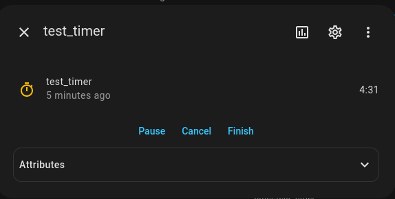

This is by design. The UI uses finishes_at to show the countdown on the screen.
