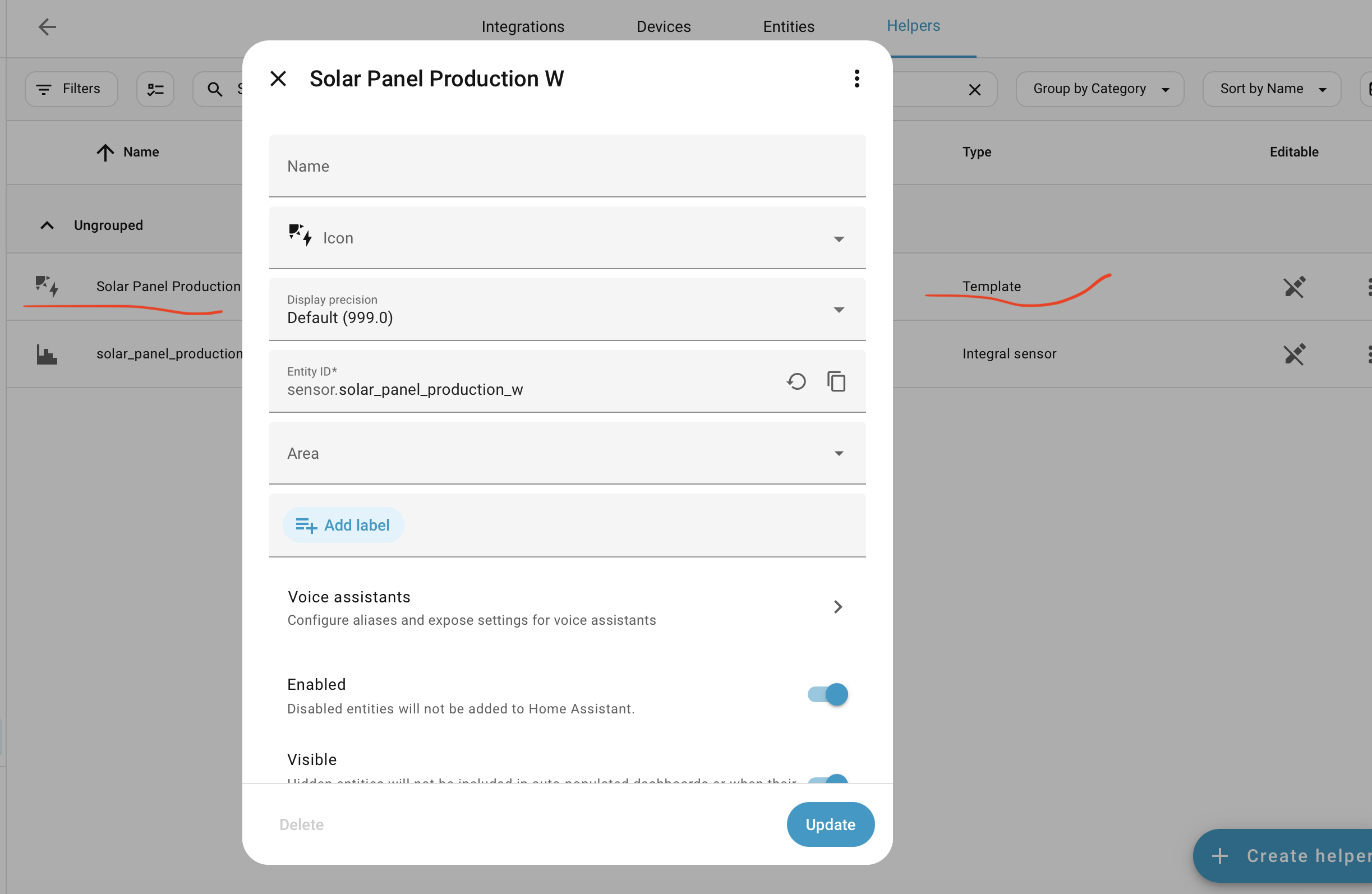

I have to PV systems, I have implemented one already and created an Energy dashboard where I can see the production from PV modules. Now I have installed the other one and I would like to add a combined production value to the dashboard. I wanted to create a helper where I sum both values to one but not really able to do that.
I have tried to create similar helper as the existing one but if I take the existing one as a template I’m not sure how to go on.

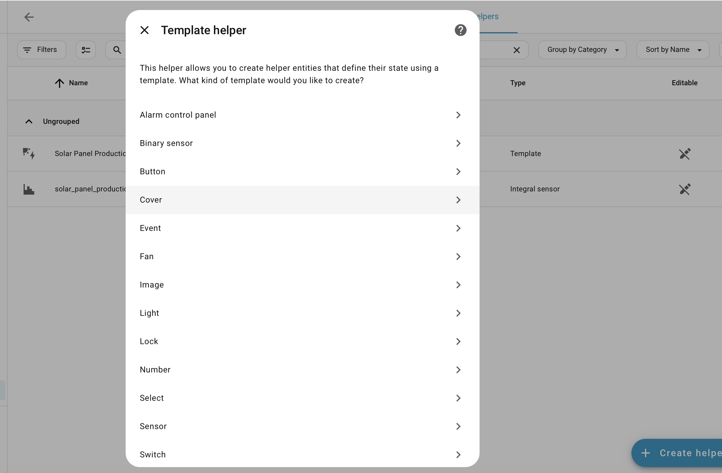

I have clicked on the “create helper” as I see them the current helper was created from a “temple” I selected the “template” option and stuck on the next windows as I can’t see what to use on the existing helper.

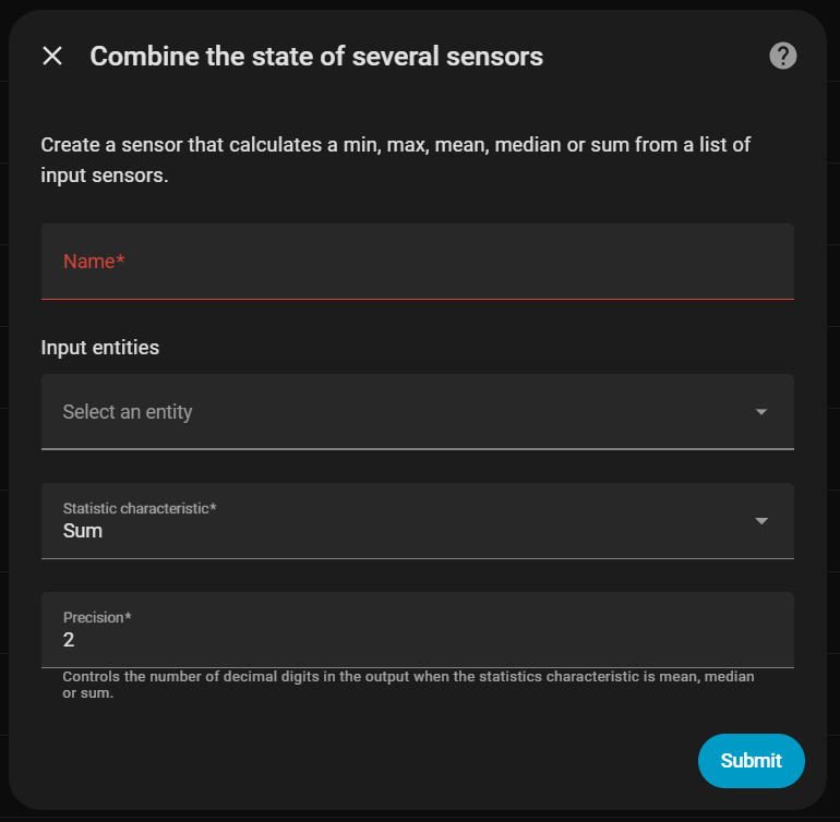

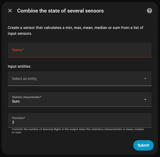

You could use this helper:
Create an template sensor with this:
{{ ((states("sensor.your_sensor_1") | float(0)) + (states("sensor.your_sensor_2") | float(0))) | round(2) }}
If you want your value to have an unit, use this:
{{ ((states("sensor.your_sensor_1") | float(0)) + (states("sensor.your_sensor_2") | float(0))) | round(2) | string +"your_unit_here" }}
round(2) means 2 decimals in the value if you want to change that.
