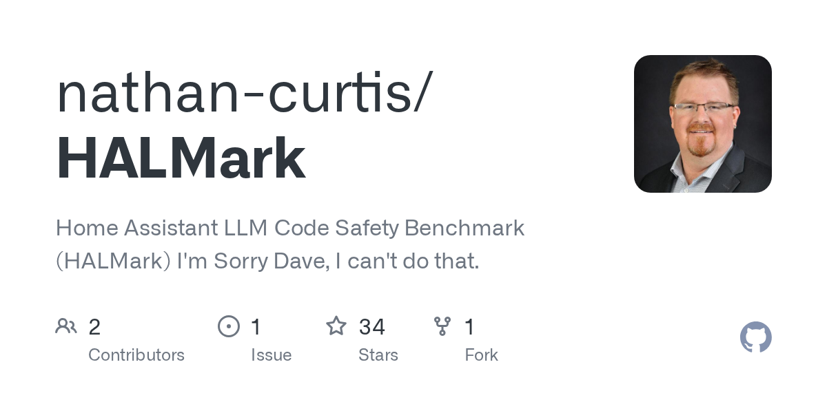

Hermes is just another loop agent and suffers from the same issues other loop agents do.
Make sure you are doing something to give you agent rules if the road. And if you don't have any I've got the ones I use for my ZenOS build work here.
I neither condone nor deny a loop agent connecting to HA. Just tell your agent to do it safely points tell them to ingest that and make it part of whatever memory system you're using on the agent that talks to HA.
(it covers a lot of the common mistakes your agent WILL make.)

Thx!!
Looked at your impressive repo and I'm now integrating it into Hermes Agent as a mandatory way of working.
I'll let you know the outcome.
If you'd like, I can share the skill.md that integrates your repo with Hermes agent.
If you care to.
I usually go - agent read that. Pull it in. Done. It doesn't require much formalities just that you point your agent at rules. I also strongly recommend a Karpathy style agent memory system in something like Obsidian.
Memory and rules and tools..
First version of skill.md, to be used in Hermes Agent. Let me know what you think!
First it will create a local copy of the spec spec/halmark.md and also prepares a folder for tests. If you update your repo, it should also notice me.
Point of attention for re-use: in my containerized setup Hermes Agent uses /opt/data/ as local storage path. This should be changed to reflect your setup.

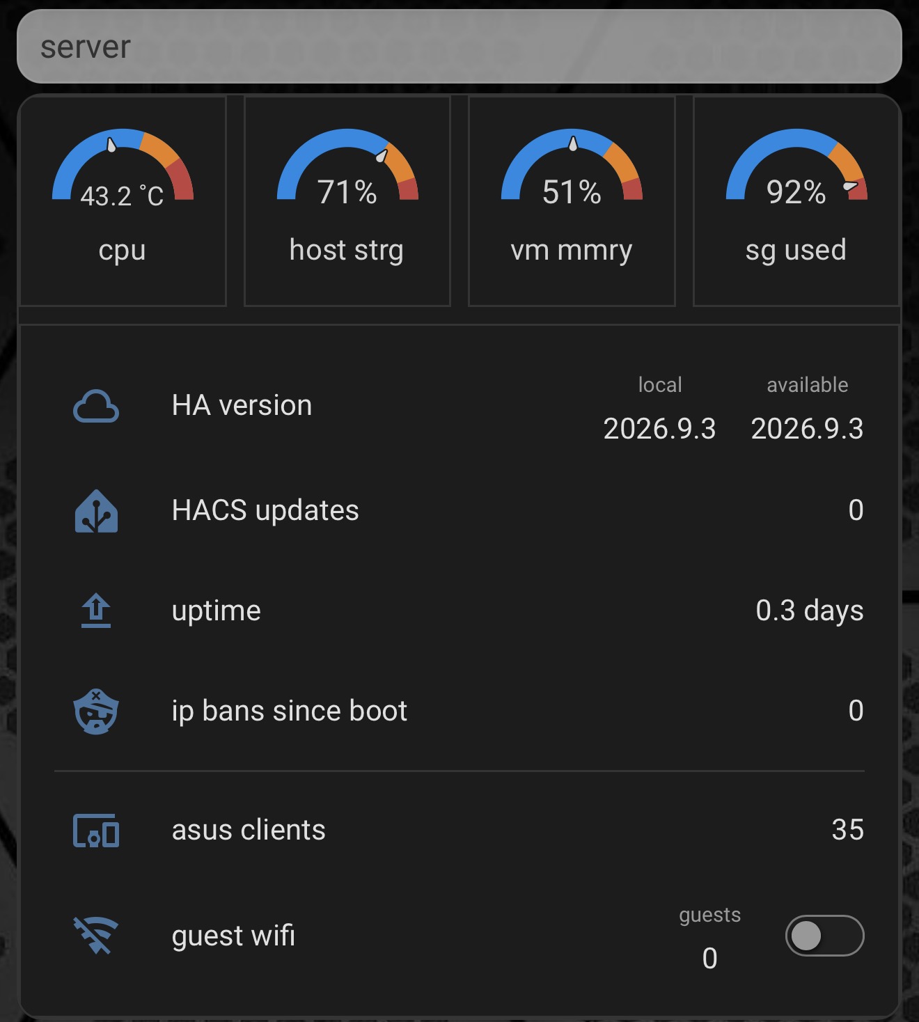

Jumping back in on what OP said, I can’t believe how easy this is getting using a Hermes agent to do HA work. I have Grok 4.7 on the backend currently and gave it ssh access to the UTM HA VM. Zero hiccups. Ex: I said, hey, build a sensor that tells me how much of my weekly SuperGrok allowance is left and replace (some other gauge) with it in appropriate views. Five minutes later…
