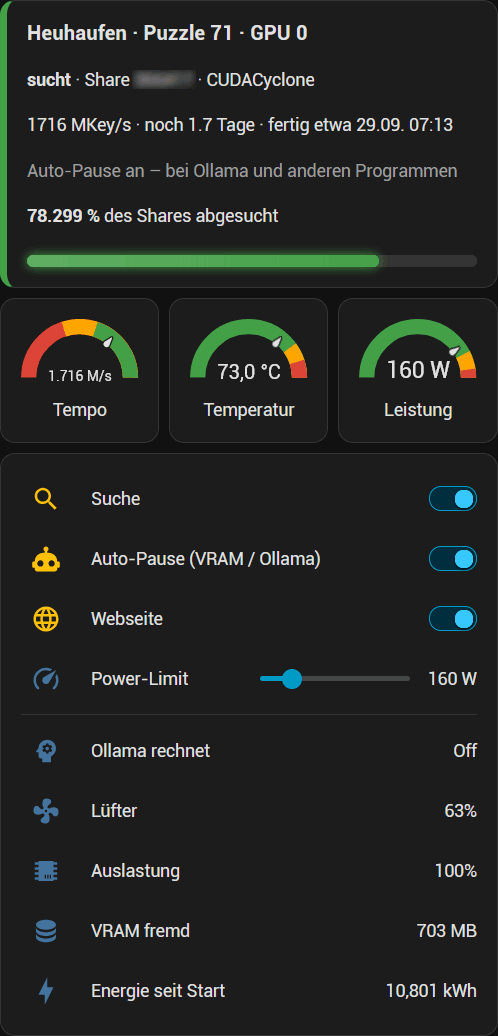

There is a ready-made Lovelace card in the repo (homeassistant/heuhaufen-karte.yaml) with the gauges and switches from the screenshot; you only replace the entity prefix with your own.
