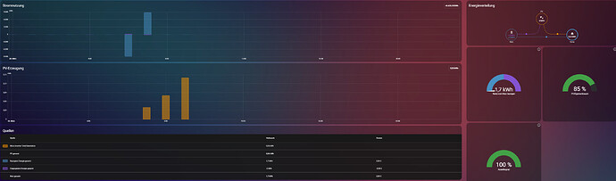

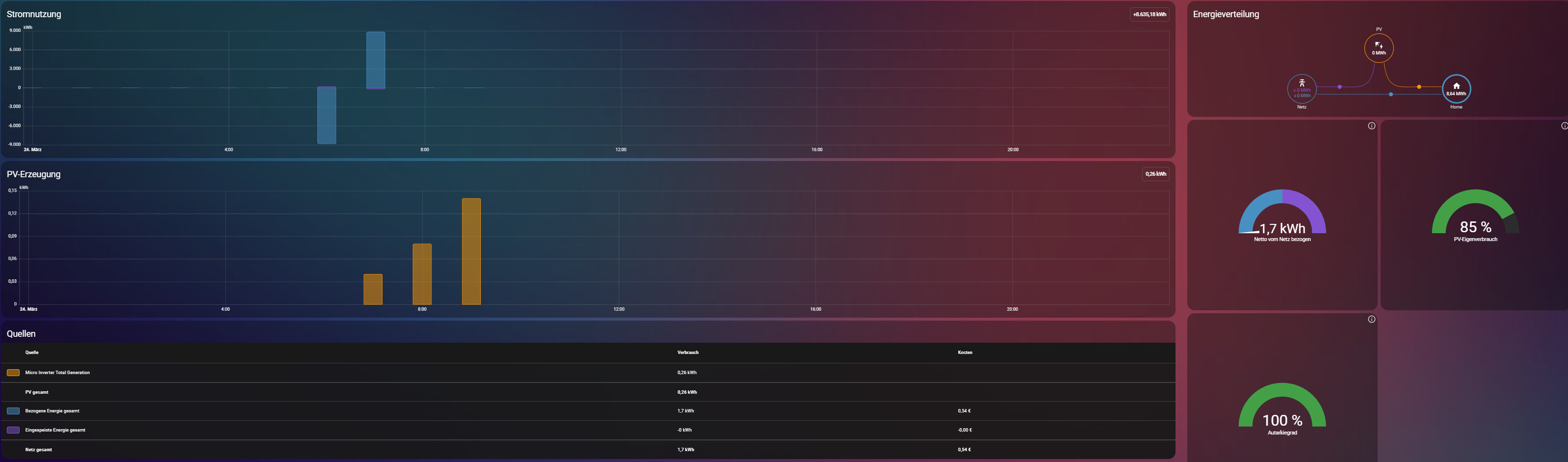

Hi everyone,
For some reason, my Energy Dashboard almost always shows extreme values: first the total meter reading as a negative value, and then the total meter reading as a positive value.
