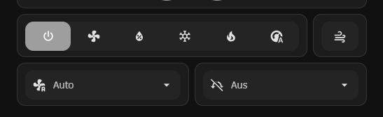

So the latest update seems to have broken this again. Not terribly, but the icon/name screen space is now there, so everything shifted down a bit. I fixed it by adjusting margins, but some of the buttons can't be selected because of the overlap between tile cards.
Anyone know how to revert it back to normal?
Edit: I had a play around with it and now know the problem. The title & icon space is now overlapping the card directly above it, so I can't select that card. Having display: none for ha-title-info and ha-title-icon doesn't help at removing the overlapping problem. Does anyone else have any ideas?
Hi! I have several tile cards with the following code. Displays exactly how it should be (maybe margin needs some adjustment if you vary the height)...
card_mod:
  style: |
    ha-card {
      height: 62px !important;
    ha-tile-icon {
      display: none;
    ha-tile-info {
      display: none;
    hui-card-features {
      margin-top: -45px;

Ok so I’ve finally have had some time to get my home assistant updated to the latest version and switch over to UIX… and it turns out all I was missing was what was previously posted and I somehow completely missed it
    hui-card-features {
      margin-top: -45px;
So everything is working great again, thank you all!
