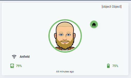

I’ve just redesigned my person cards using custom buttons for all the info, which is different to how I did it before. I have everything formatted as I want and it all works, but I’m trying to hide a couple of the buttons if I’m at home. I’ve added the conditional card to my code and get no errors, but on the card I get [object Object] when I use it. Is it an error with my code, or is it just not possible?
The formatting looks odd in the image, because it’s usually part of a vertical stack.

card is missing, and hyphen should be removed:
                      work:
                        card:
                          type: conditional
                          conditions:
                            - condition: state
                              entity: sensor.dave_current_location
                              state: home
                          card:
Thanks, can’t believe I missed that.
