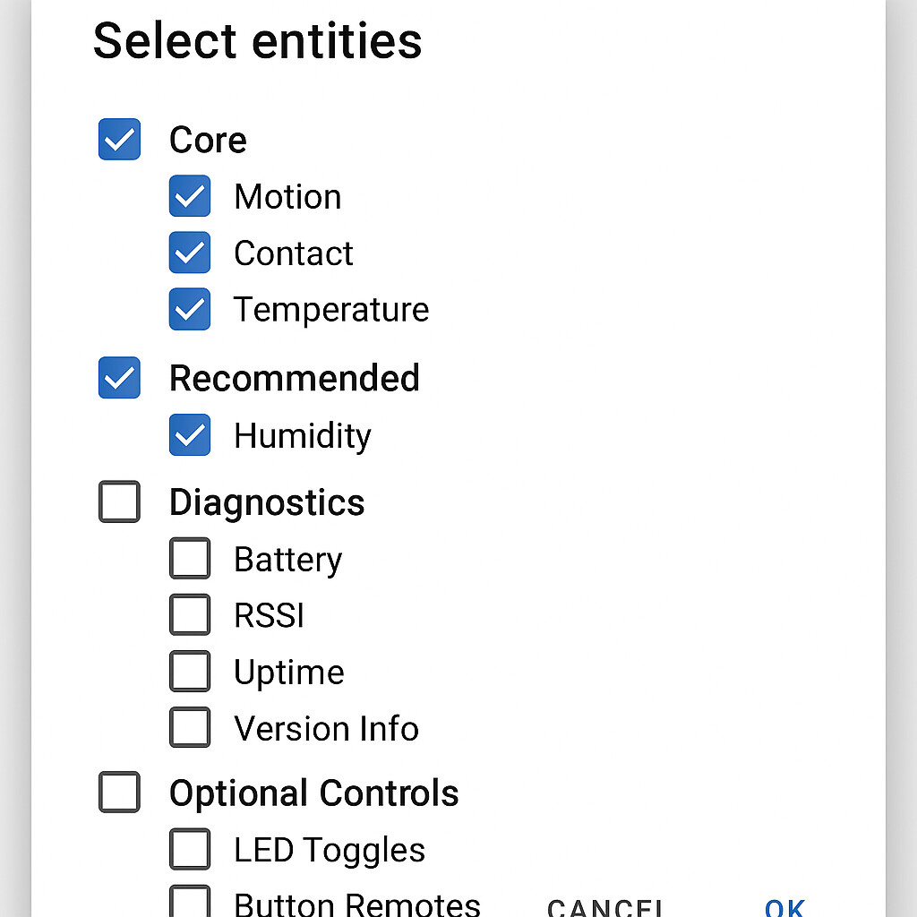

Proposed Solution: Hierarchical Entity Picker UI
Introduce a step during device onboarding (e.g., right after entity discovery) that:
  1. Displays entities grouped by function or category, such as:
  • Core functionality (e.g., motion, contact, temperature)
  • Recommended (frequently used sensors)
  • Diagnostics (battery, RSSI, uptime, version info)
  • Optional controls (e.g., LED toggles, button remotes)
  1. Uses checkboxes or toggle pickers to allow the user to enable or disable groups or individual entities.
  2. Retains current behavior as default (enable all), but offers an opt-in UI for advanced or curated setup.
  3. Leverages existing entity_category values (diagnostic, config) and possibly introduces new tags or groups to facilitate better UX.

Example of possible feature implementation…

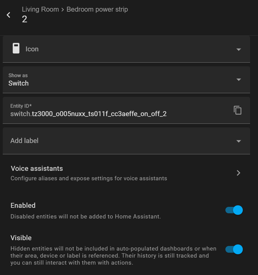

Yes, of course it can.
First things first - you keep referring to “entities” as “attributes”. Please learn the difference.
Each and every entity in HA allows you to disable or hide that entity after onboarding the device. It also gives you the flexibility to re-enable the entity at a later date should you change your mind:

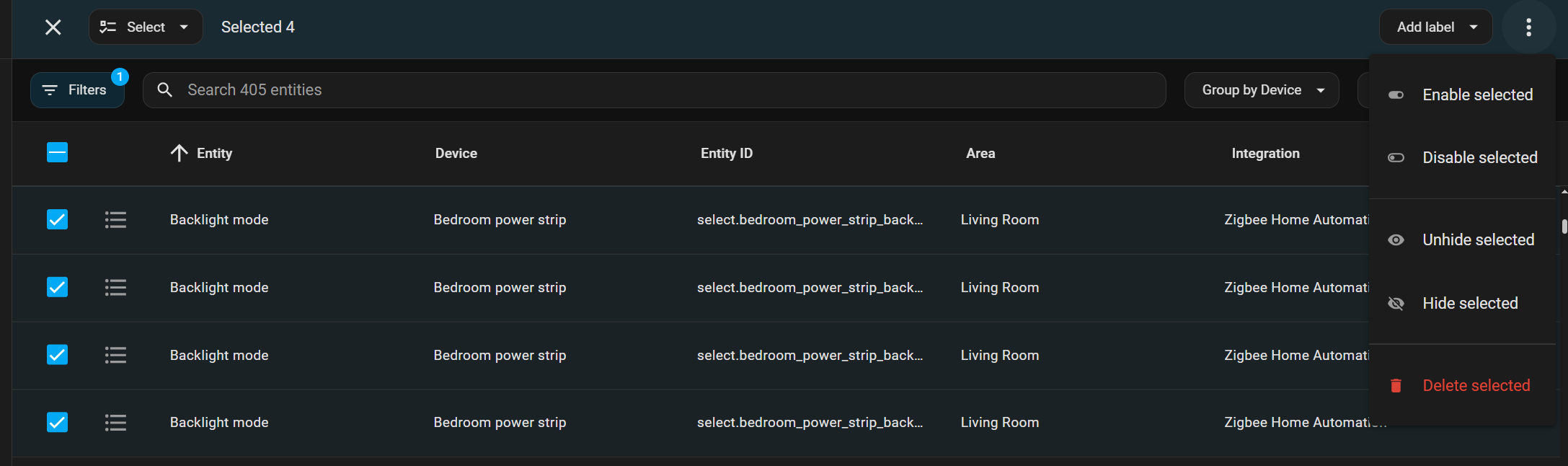

EDIT: Saw that you snuck in an edit to your original requirement as I was writing.
Yes, you can also do this via checkbox. Go to the entities page & Click the multi-select icon & choose your entities (use a filter if you don’t want to be overwhelmed). Click the 3 dots in the top right and you can enable/disable, hide/unhide the selected entities
