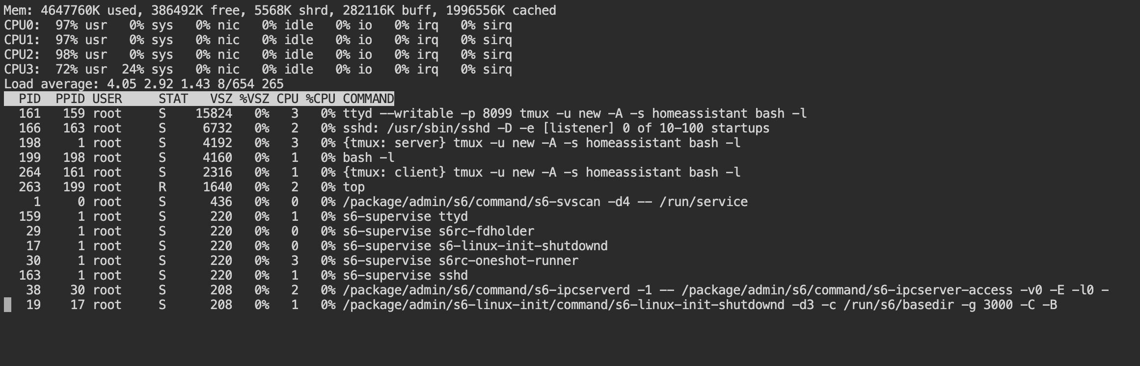

I've been seeing (and hearing the fans) CPU spikes in the past few days.
Noticeably I have upgraded the Proxmox version from 8 to 9 mid week.
I've booted into safemode and the issue still remains.

Screenshot from the top command within terminal.
Since booting into safe mode I see these lines in red in the logs. Booting into safemode has actually made it worse, the CPU seems stuck at 95% all the time now!
