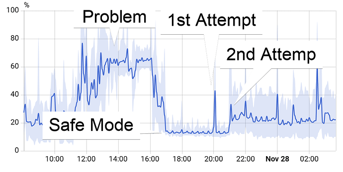

Hi, I had a bit of yesterday that Home Assistant was near non-responsive. I ran top and python3 -m homeassistant --config /config was pegged at 100% :open_mouth:. Rebooting didn’t help. First time I’ve had to use safe mode. I did use profiler before I put it in safe mode, however I’d never figured out how to use Snakeviz in the past, so it was more a “following the forum guidance” kind of thing. In safe mode my CPU via system monitor dropped to ~13%.
After a few hours I switched off safe mode and it’s been ok since. CPU has been 21-33%.
Great, it’s reletively working, but the trouble is I didn’t actually identify the problem. My “attempts” on the screenshot above are just switching from Safe Mode. The first time when I checked top, the same python3 -m homeassistant --config /config process had high CPU and I didn’t have time to troubleshoot so I just turned Safe Mode on again.

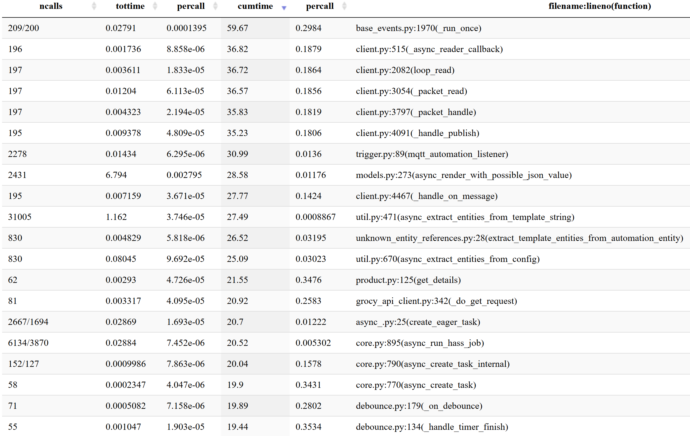

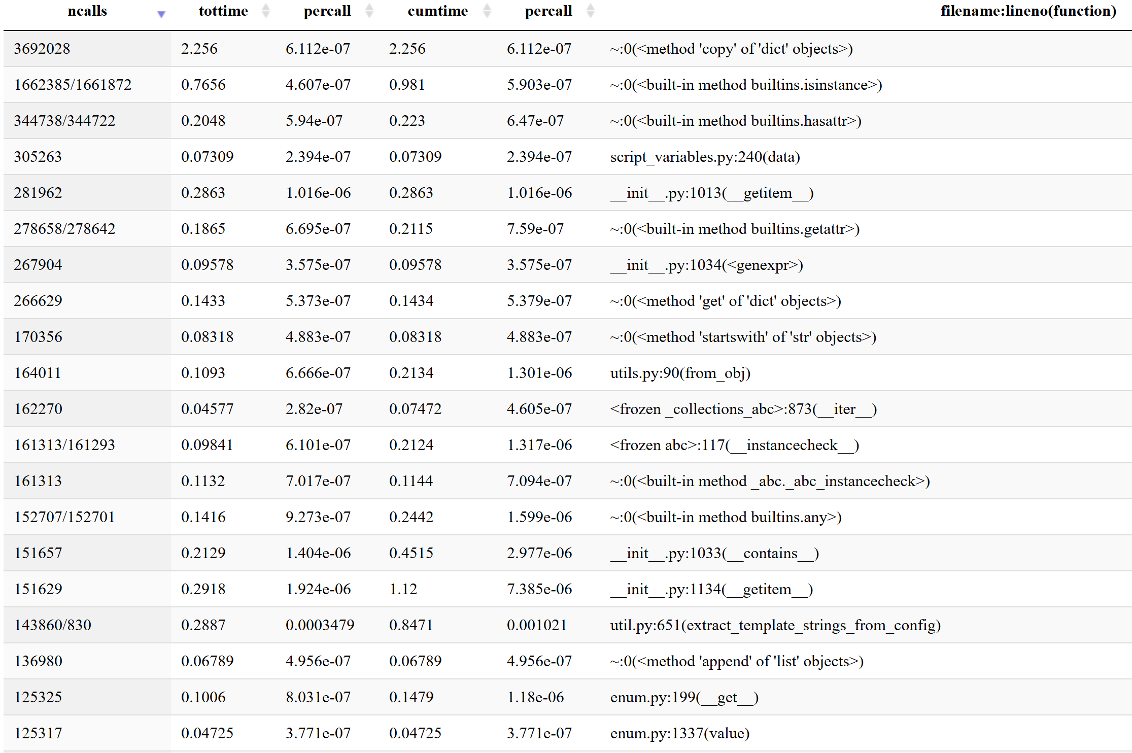

Later I figured out how to install and use Snakeviz with WSL. Nothing made since I was only seeing that base_events.py was taking ~59/60 seconds. That seemed like a lot, but the chart didn’t look anything like what I was seeing in the screenshots. After tinkering I finally asked an LLM that suggested “Something is blocking the event loop” and to share my top 20 functions which I did.
Snakeviz screenshots
Top 20 sorted by cumtime
Top 20 sorted by ncalls
The LLM suggested initially that MQTT was the culprit, but after the ncalls sort it pointed more towards template loops. Incidentally I did recently add a couple in helpers. So, the bulk of this whole big post is to ask if any of you Jinja/Python gurus would take a look at this to tell me if anything else stands out as a problem AND to look at the templates that I’ve identified as likely problematic and if you’re willing, give me some guidance on improving them.

Does anything stand out on the profile to either of you?
