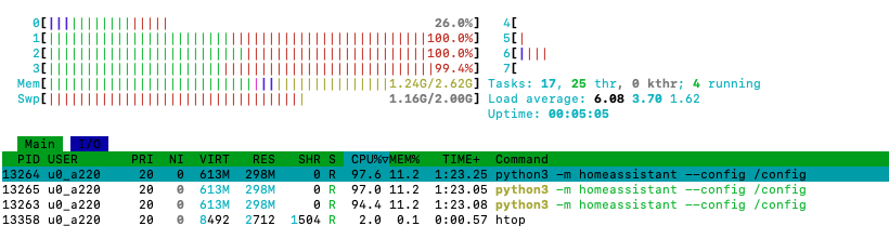

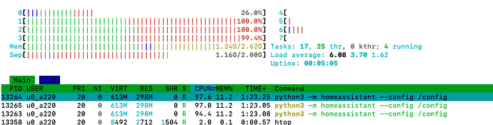

I don’t know how to do that within cachegrind. When I look at the processes that are running (using ps, top, htop, etc) - I see:
Or maybe this is helpful from top -H:
  PID   TID USER     PR  NI CPU% S     VSS     RSS PCY Thread          Proc
25440 25869 u0_a220  20   0  12% R 631808K 375428K  fg SyncWorker_6    python3
25440 25870 u0_a220  20   0  12% R 631808K 375428K  fg SyncWorker_6    python3
25440 25871 u0_a220  20   0  12% R 631808K 375428K  fg SyncWorker_6    python3
Not always the same SyncWorker_n – the next run of HA it was 1.
There may be a relationship with the number of cores I let HA use. I was limiting it to 4 of 8, and would get three cores at ~100% (each is 12% 100/8). When I let it use all 8 cores, I know have 7 threads using ~100% cpu.
27501 27978 u0_a220  20   0  12% R 762148K 373932K  fg SyncWorker_5    python3
27501 27982 u0_a220  20   0  12% R 762148K 373932K  fg SyncWorker_5    python3
27501 27981 u0_a220  20   0  12% R 762148K 373932K  fg SyncWorker_5    python3
27501 27977 u0_a220  20   0  12% R 762148K 373932K  fg SyncWorker_5    python3
27501 27980 u0_a220  20   0  12% R 762148K 373932K  fg SyncWorker_5    python3
27501 27983 u0_a220  20   0  12% R 762148K 373932K  fg SyncWorker_5    python3
27501 27979 u0_a220  20   0  12% R 762148K 373932K  fg SyncWorker_5    python3
27501 27501 u0_a220  20   0   0% S 762148K 373932K  fg python3         python3
15615 15615 u0_a220  20   0   0% S  35640K   2316K  fg sshd-session    /data/data/com.termux/files/usr/libexec/sshd-session
