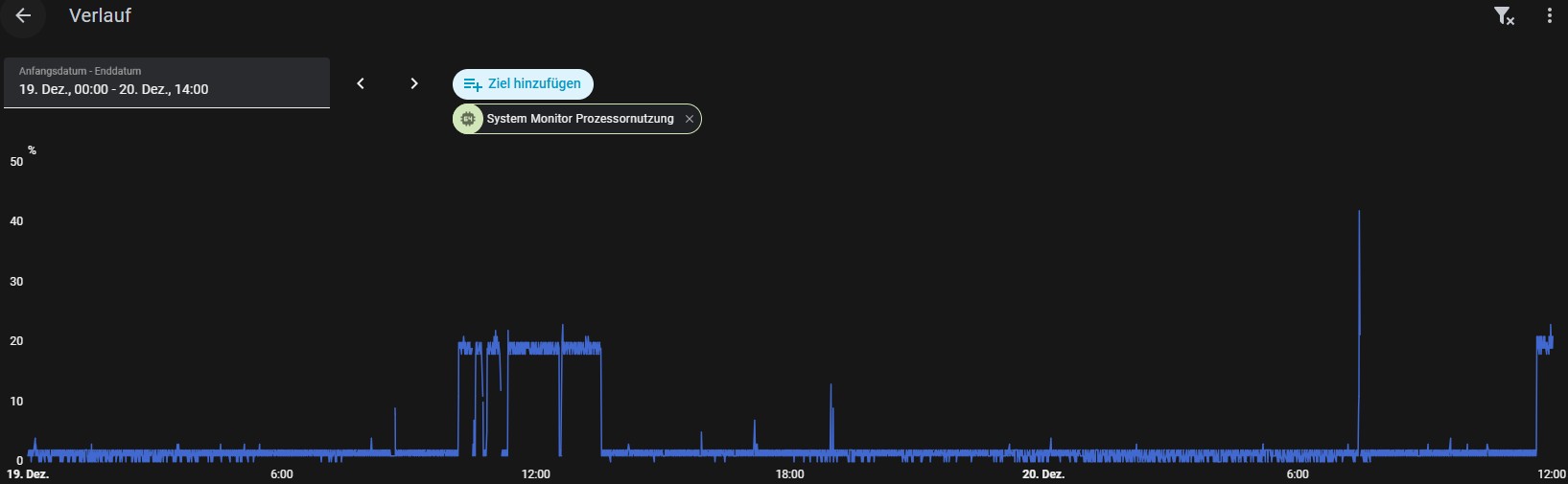

My HA is installed on Proxmox as a virtual machine: 8GB RAM / 40 GB HDD. For some time now, I have noticed that the CPU load, which can be seen both under Proxmox and under Home Assistant, occasionally spikes significantly.
Unfortunately, I don’t have a good starting point for where to look. The error log does not provide any direct clues.
Has anyone else noticed this? Can you give me some tips on where I could look? At the moment, I’m a bit at a loss.
Thanks a lot for your help.
Ronny
Does it impact anything at all? If not I wouldn’t think about this, a small period of time at 20% and a single spike at 40% isn’t worrying.

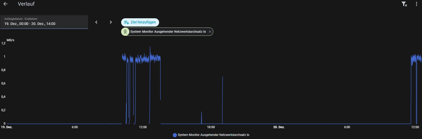

No. But I also have a spike of network activities. See here:
CPU2
I think, thats not normal, isn’t it?

Are you actually seeing any issues magnifying glass to your chart
That graph shows a machine idling at best. You don’t have an issue. It’s single digit mostly of the time and ten to fifteen in a burst. That’s normal use of an idle box. There was one high pop and it lasted for nearly no time. Unless the machine froze during that one spike
Machines are ‘spiking’ when they jump and sustain utilization at an abnormal level that impacts performance. Your machine is simply responding to a request and handling it and clearing it out
The reason I bring this up is… As a perf guy I don’t see anything here’s concerning… Hell I don’t even concern myself with a machine less than 50% loaded if there’s no apparent latency…
If the box isn’t doing anything weird I’d leave it alone… If you spend your time chasing anomalies like this forever you’ll never actually use the thing. So is it actually acting up?
