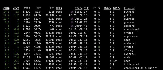

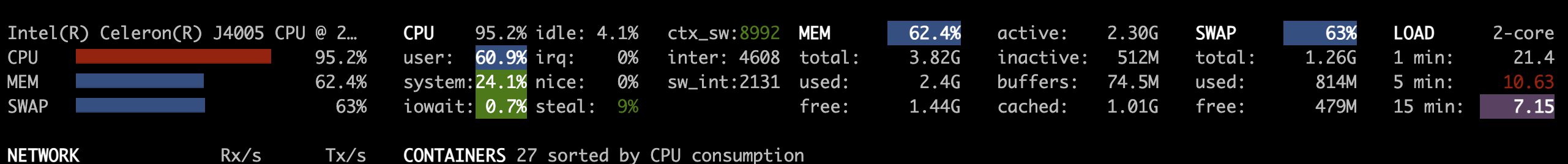

I checked glances for some time, and I see that it has high load and high swap:

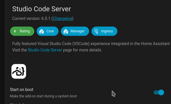

If you have vsCode add-on running, that might take over 1GB alone, so watch out for that one for sure.
Cameras seem to be sucking up alot of resources.

I have a view with all my cameras and I use that quite often. I also have two wall panels that show area cards with the camera image as miniature.
Can that be the cause? Is there a way to make this work better?
I have now around ~11 cameras
If you only start it when you are using it, then stop it, you are OK. While using it it takes a lot. Experiment you will see.
Cameras are more bandwidth as opposed to memory.
2gb of memory and the seemingly inability to upgrade that (or you would not have had this question) lets me thing some kind of pi based server. 11 cameras as well.

Does it start automatically or I need to go to integrations and then activate it? If it is the former, I can give that a try.

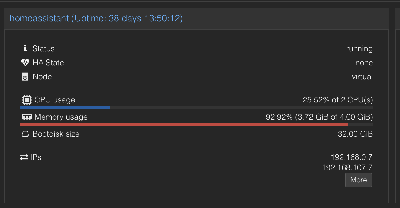

Why do you think it only has 2gb of memory? Because the glances screenshot? That screenshot is probably not showing all the ram accurately. It is a VM in a nuc within proxmox, and it has 4gb of ram available and very low CPU usage:
I think those should be plenty of resources for HA.

In the add-on there is a selector to start auto or start it when you want it.
Yes if you have a VM then OK. I read this stuff and saw a PI4 2gb in my head. Sorry about that.
