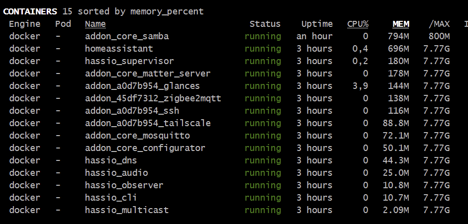

Any other add-ons running? I’ve never had any problems with Samba (either on a Pi4 or a “real” computer) but things like Studio Code Server will eat away at system resources until there’s nothing left, even if you’re not using them.
That’s certainly true, but with glances I can see this Docker container is immediately maxing out my RAM when I write to or read from the SMB share:
