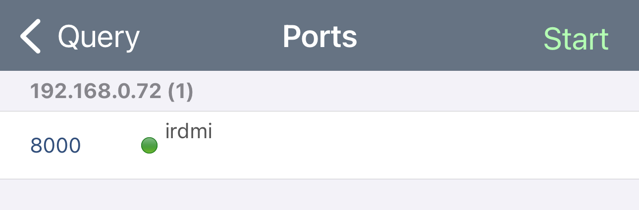

Check if port 8000 is used on your device, maybe there is no SDK for it
Doorbell
Reader
:frowning:
Ah , and connecting to 72 doesn’t work either?
It’s a device with 2 IP addresses?
No, no. .72 is the doorbell. I checked just to see what a working device responded to the port check. The reader is the .74.
Sorry, I don’t understand, the addon needs to connect to the doorbell, the .72 is an Hikvision device, right?
.72 is the doorbell, which it is been always working fine with the addon. Now, I am trying to connect the fingerprint reader to HASS as well (just trying to see I can log events with the addon). I just included its web admin credentials and IP to the addon config (the .74 one). The .71 is the indoor screen:
All devices are Hikvision’s.
But I understand that your addon is for doorbells only, so I cannot connect any other devices type to it, is this correct?
That’s correct:-)
Ok. I guess I will have to live with it or try to find a way to link the reader to the doorbell, and see whether I can log accesses through the doorbell. Thanks anyway for your time!
