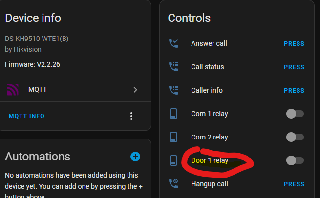

if success, I should get in the attributes a result like the one I can see in your screenshot for kh_9510. Unfortunately I always get empty attributes using all the ISAPi commands you suggested. I suppose the Doorbell is not replying with any information… :cry:
Yeah, it doesn’t work either on my outdoor :slight_smile:
No luck… I tried everything… Fabio, let me just understand: if I buy an Hikvison panel, like for instance DS-KH9510-WTE1(B) I’ll will able to read in HA the status of the AN1 input present on the Outdoor station through the panel? OT: Do you know if I can run Home assistant companion app on this panel?

Thanks Fabio. You mean your addon reads the zone event only on the indoor panel, right? Anyway, thanks for your valuable work, I sent you a contribution a couple of days ago. Bye
yes, only zone events on indoor, i dont think the zone inports on outdoor actually work, never tried it :slight_smile: , maybe …
i only use locks on the output relays on outdoor

The beta version seems to have solved my problem!!

Alright thanks. That means I’m stuck with “just” being able to open gate with the HikConnect integration. Thanks for the reply.
when adding indoor station to addon, some indoor panels support opening door, try this button:
