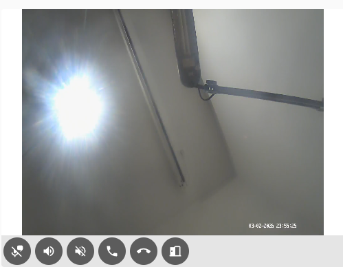

Hi Fabio!
First off, thank you very much for working on this super useful addon!
I’ve been having fun with it for a few days now and I got stuck pretty close to the end, I think :slight_smile: I would appreciate a little help - I read a few months worth of posts here and saw a few messages about my kinda problem, but no solution, sadly.
Here’s my setup:
  • DS-KV8113-WME1(C) running the firmware you provided here recently (V3.7.0 build 251217)
  • no indoor station (i want to use a tablet with HA companion instead).
This is where I got:
  • go2rtc with HASS web proxy configured. Two way audio works through external WebRTC viewer
  • I have an automation based on changing call status working. It sends notification to my phone when I press the bell button on the doorstation.
  • I have advanced-camera-card configured, the video works and I can activate the relay
What I can’t get to work is the two-way audio through the Advanced Camera card. The buttons to mute/unmute buttons don’t seem to do anything (nothing shows up in the log). A call initiated from the doorstation gets into the logs, but I can’t answer or reject it on the Advanced Camera card.
The Advanced Camera card setup is fairly standard:

Log message for rejecting the call (regardless of whether the call was initiated):
2026-02-04 00:07:51.316 | INFO     | mqtt_input:_isapi_input_callback:534 - Received input text for doorbell: Furtka
2026-02-04 00:07:51.320 | DEBUG    | sdk.utils:call_ISAPI:125 - Call ISAPI request method url body: PUT /ISAPI/System/TwoWayAudio/channels/1/close
[2026-02-04 00:07:51.337][INF] Private connect 172.24.103.5:8000 sock=47 this=0x80eabca0 cmd=0x117001 port=41234
2026-02-04 00:07:51.344 | DEBUG    | sdk.utils:call_ISAPI:165 - Response output:
[2026-02-04 00:07:51.344][DBG] SimpleSTDCommandToDvr with out cmd[PUT /ISAPI/System/TwoWayAudio/channels/1/close], input size[0], max segment length[262144]
Log message for answering the call (regardless of whether the call was initiated):
2026-02-04 00:08:44.334 | INFO     | mqtt_input:_answer_call_callback:378 - Received answer command for doorbell: Furtka
2026-02-04 00:08:44.337 | DEBUG    | sdk.utils:call_ISAPI:125 - Call ISAPI request method url body: PUT /ISAPI/VideoIntercom/callSignal?format=json {"CallSignal": {"cmdType": "answer"}}
[2026-02-04 00:08:44.350][INF] Private connect 172.24.103.5:8000 sock=47 this=0x80eabca0 cmd=0x117001 port=40336
2026-02-04 00:08:44.360 | DEBUG    | sdk.utils:call_ISAPI:162 - Response status: {
	"statusCode":	6,
	"statusString":	"Invalid Content",
	"subStatusCode":	"badXmlContent",
[2026-02-04 00:08:44.360][DBG] SimpleSTDCommandToDvr with out cmd[PUT /ISAPI/VideoIntercom/callSignal?format=json], input size[37], max segment length[262144]
	"errorCode":	1610612739,
	"errorMsg":	"src"
2026-02-04 00:08:44.362 | ERROR    | mqtt_input:_answer_call_callback:391 - Error while answering call with ISAPI: ('Error while calling ISAPI /ISAPI/VideoIntercom/callSignal?format=json', 11, 'The data sent to the device is illegal, or the data received from the device error.  E.g. The input data is not supported by the device for remote configuration.')
2026-02-04 00:08:44.660 | INFO     | mqtt_input:_hangup_call_callback:355 - Received hangup command for doorbell: Furtka
2026-02-04 00:08:44.662 | DEBUG    | sdk.utils:call_ISAPI:125 - Call ISAPI request method url body: PUT /ISAPI/VideoIntercom/callSignal?format=json {"CallSignal": {"cmdType": "hangUp"}}
[2026-02-04 00:08:44.683][INF] Private connect 172.24.103.5:8000 sock=47 this=0x80eabca0 cmd=0x117001 port=40342
2026-02-04 00:08:45.198 | DEBUG    | sdk.utils:call_ISAPI:162 - Response status: {
	"statusCode":	6,
	"errorMsg":	"src"
2026-02-04 00:08:45.200 | ERROR    | mqtt_input:_hangup_call_callback:368 - Error while Hanging up the call with ISAPI: ('Error while calling ISAPI /ISAPI/VideoIntercom/callSignal?format=json', 11, 'The data sent to the device is illegal, or the data received from the device error.  E.g. The input data is not supported by the device for remote configuration.')
[2026-02-04 00:08:45.198][DBG] SimpleSTDCommandToDvr with out cmd[PUT /ISAPI/VideoIntercom/callSignal?format=json], input size[37], max segment length[262144]
I read in the comments here that ā€œsometimesā€ an indoor station is necessary, but given that I have the 2-way audio tested through WebRTC, I don’t think it is my case, as it works already. I also read something similar about the Hik Connect connectivity (I’m not connected to the Hikvision cloud - I do have a local-only Hik Connect app on my phone, which works, though obviously without notifications).
Any help to push me forward will be very appreciated! I’m hoping that I won’t have to go the SIP way…
Well, if you press the doorbell button. And there is no hikconnect or indoor. What device is then actually ringing?? The callsignal commands only work when there is a real device ringing and it will stop the ring by sendjng a fake callsignal command…
I think that’s the reason why you see those fails…
Also answer+hanguo only works, when connected to cloud. Try to use reject instead and test when an actual device is ringing, in your case I think you are going to need hikconnect anyway (not sure)
I have also heard from other people, with that custom firmware some commands were broken. So to be 100% sure, maybe downgrade to the non 3.x version again?
Edit; if you see the ring event, what device is ringing then in your case? Maybe you don’t need to send the answer/hangup at all? Why not just use the microphone button and start two way audio?
The mute/unmute buttons don’t do anything offcourse when the microphone icon is not activated… Just press the mic button ? Will it change to red? Then you have activated the two way audio? No need to send then answer+hangup
