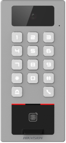

Technical API Discovery for Hikvision DS-K1T502 (Access Control & Intercom Hybrid)
Device Model: DS-K1T502 (Access Control Terminal with Video Intercom functions) Firmware Version: 1.19 / 1.20 no major change between the two.
Some picture
  1. Handling the Doorbell (Call Button vs. Bell Button)**
The device has two buttons.
  • Call Button (Phone icon): Triggers a SIP/VoIP call. It does not appear in the HTTP push or alert stream.
    • Solution: Status must be polled via GET /ISAPI/VideoIntercom/callStatus?format=json.
    • Ringing state: {"CallStatus":{"status":"ring"}}
    • Idle state: {"CallStatus":{"status":"idle"}}
  • Doorbell Button (Bell icon): Acts as an alarm trigger.
    • Event: Major 5 / Sub 37. It is pushed instantly via HTTP Listening.
