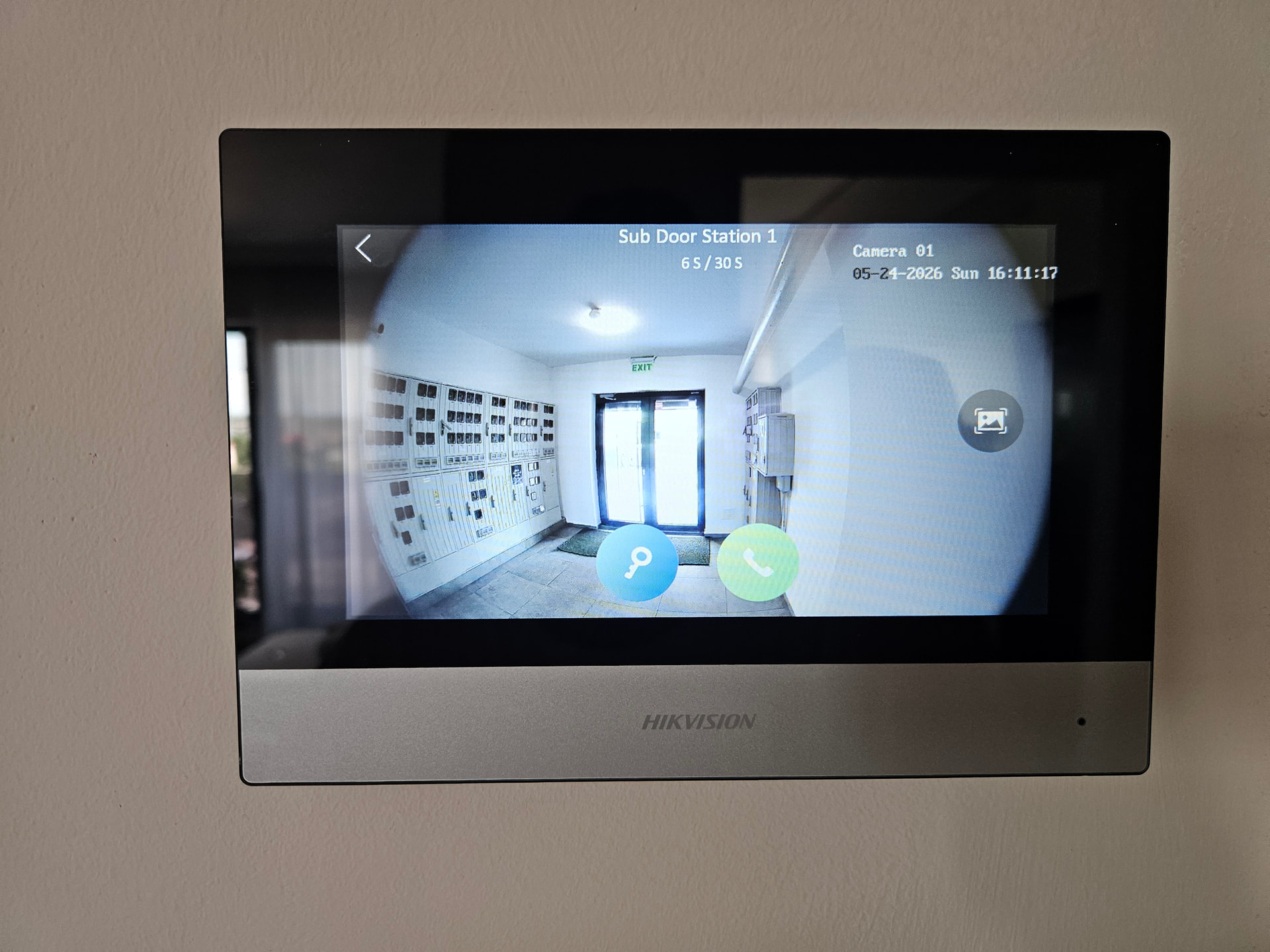

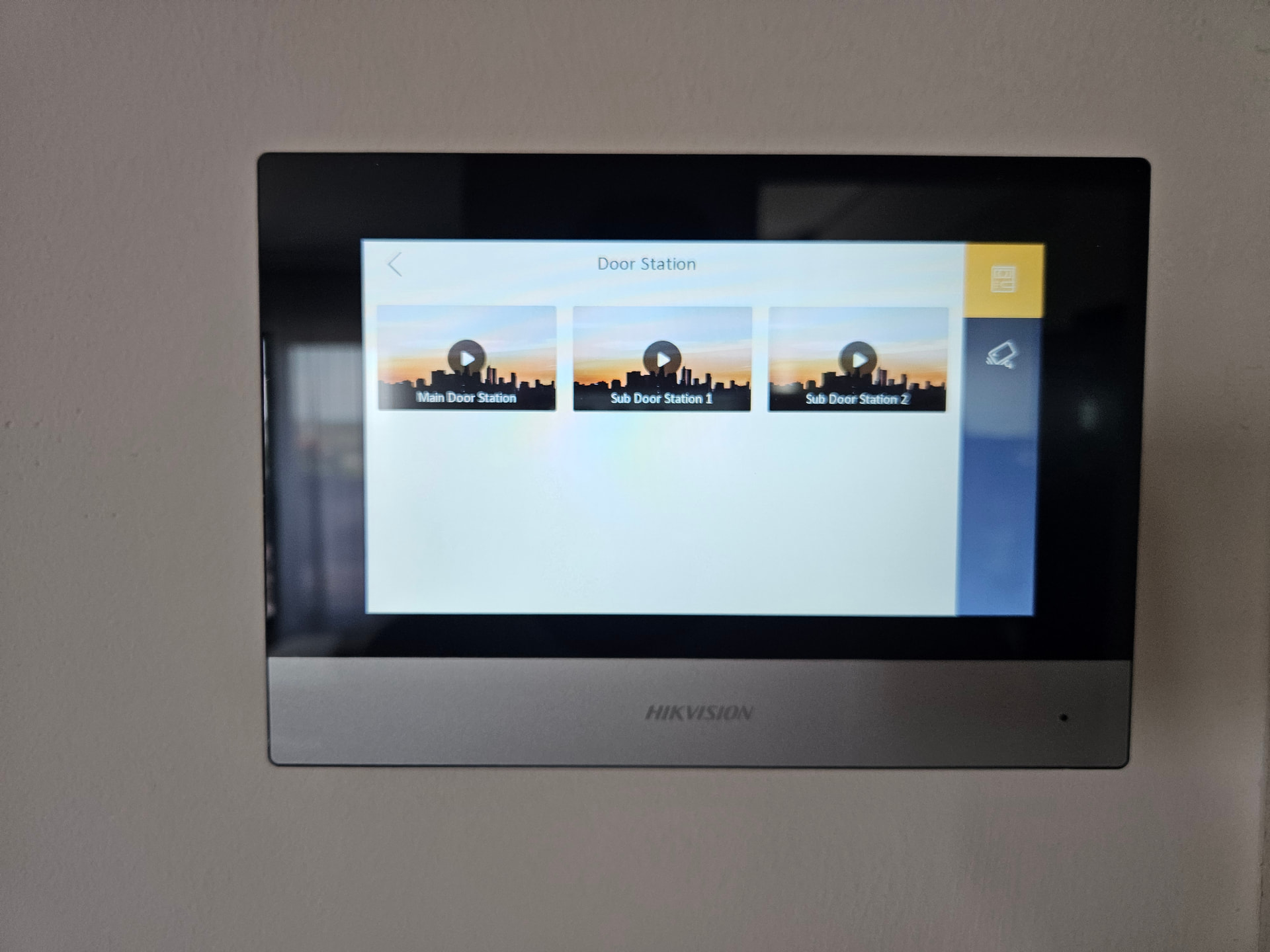

Hi, In my appartament I have DS-KH6320-WTE1/EU. There are 3 outdor units which are accessible for all the appartaments in the building (so they are not in my WiFi network)
In Hik-Connect I see the 3 cameras and I can unlock the doors.
So I've set output relays = 3. But only the first one is working , not the other 2 ... :frowning:

From your indoor station itself, can you do an unlock door there? My guess , they are 3 separate devices , now you are only connecting to one indoor and you can only unlock the linked outdoor station...
Hi, yes, i can unlock any of the doors from my device. U need to go on the associated camera, and then i have the unlock option. The pictures are, e. g., for the second door which is currently not working from the homeassistant App.
I maybe know why, I always send the command to channel 1.. maybe you need to send to channel 2

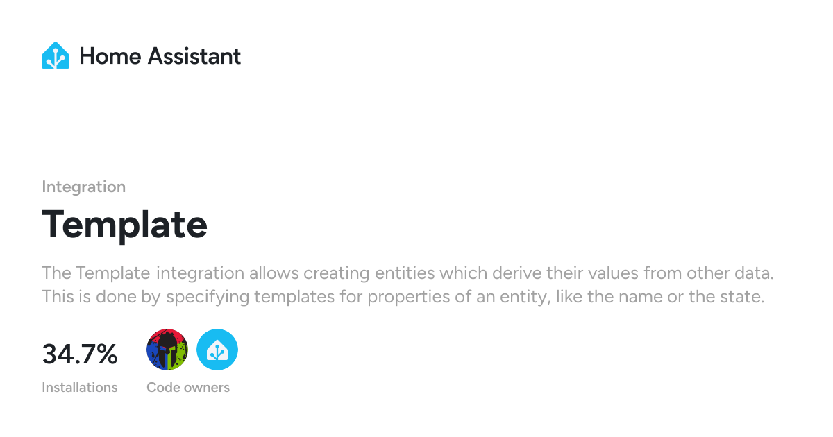

Can I do this in a HA script ? (to define the commands for each door) or a "Hikvision Doorbell" App update is needed ? :thinking:
That's good, yeah. You can create an custom script or template switch to send that command indeed
Silly question : how do I do that ? Do I just write the string in the text.interfon_isapi_request , and then I set it back to "empty" ? Or is there any special "action" available to send the ISAPI command ?
No need to set empty. Just create a switch to send that string...
