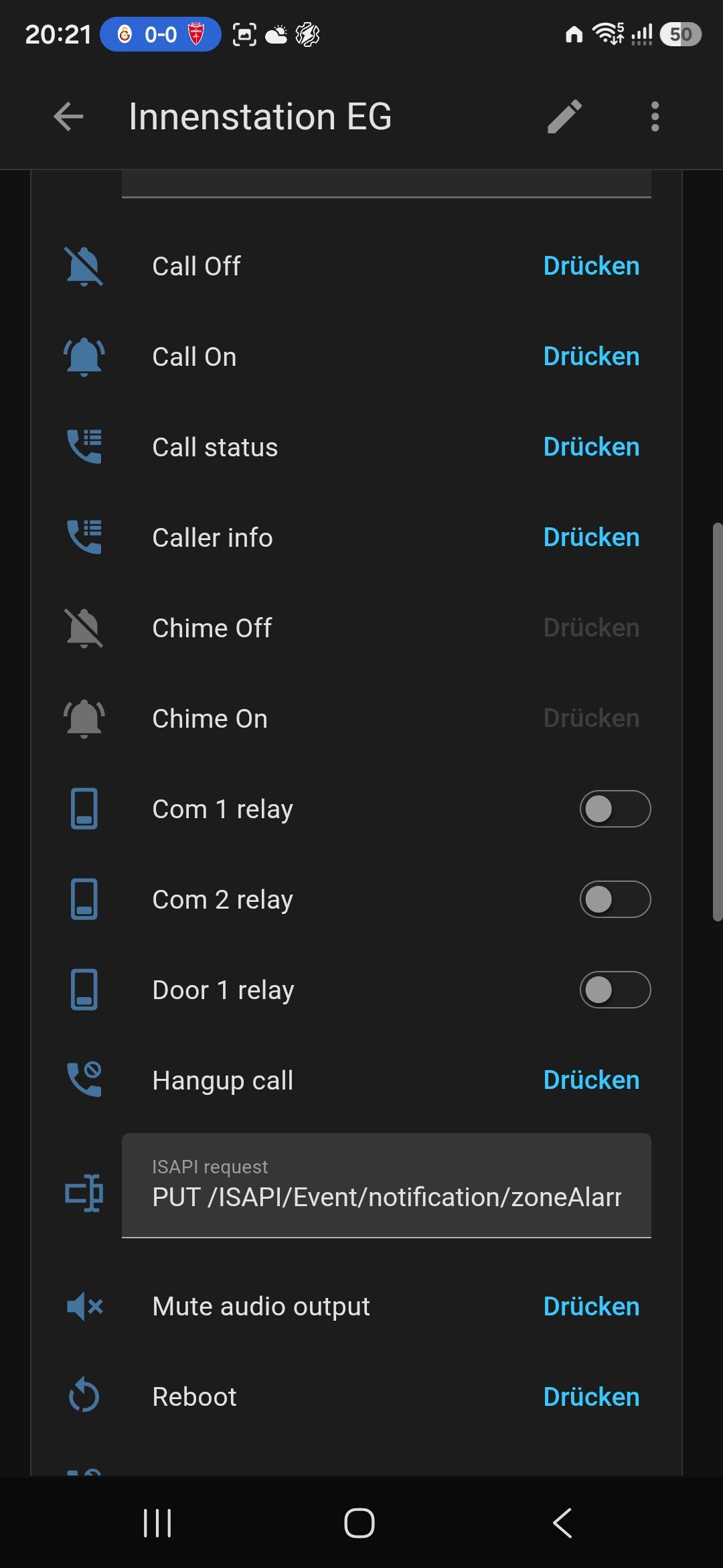

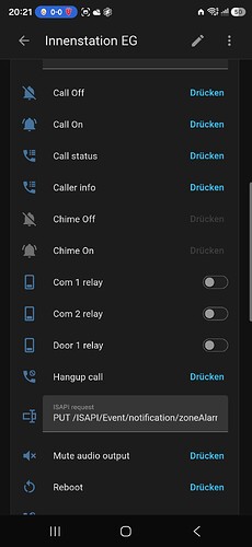

Hi Fabio,
I noticed that the ā€œChime Onā€ and ā€œChime Offā€ buttons are always greyed out in Home Assistant, so I can’t trigger them manually.
Is this expected, or should they normally be available?
Correct, I changed names… Stop addon delete the MQTT device , start addon and new entities with new names are being created, the are named now call on / off and broadcast
