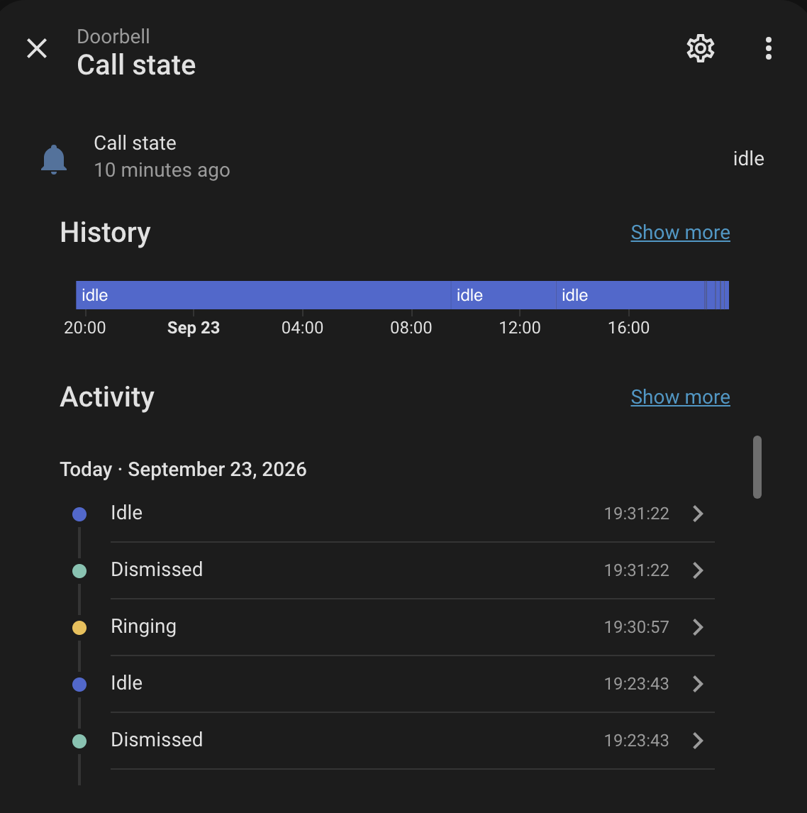

I was updated my outdoor station, will check call state after work.
I disabled Call State polling and can still see new states in Call State. There is no “Ring” state, but there is a “Ringing” state.

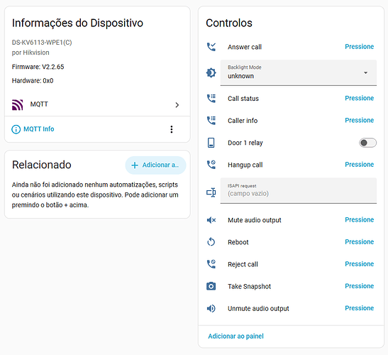

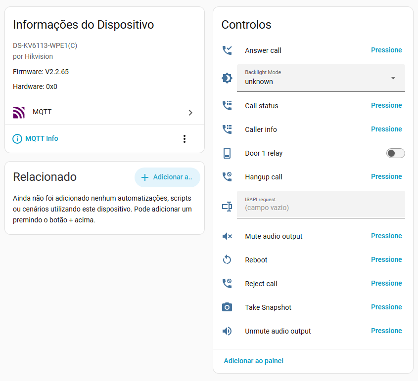

I have a DS-KV6113-WPE1(C), Firmware V2.2.65 build 231213, no interior panel.
Problem: It does not ring… I press the button and it gives 3 “occupied” signals
I can see the entity over home assistant and even unlock the gate.
I’ve been searching on these threads and testing things for hours, but nothing seems to get it to work.
Thanks in advance,
If you hear busy sounds, that’s not related to this addon… That means you are not calling a device, like an indoor or hikconnect… A device must ring in order to receive the event
