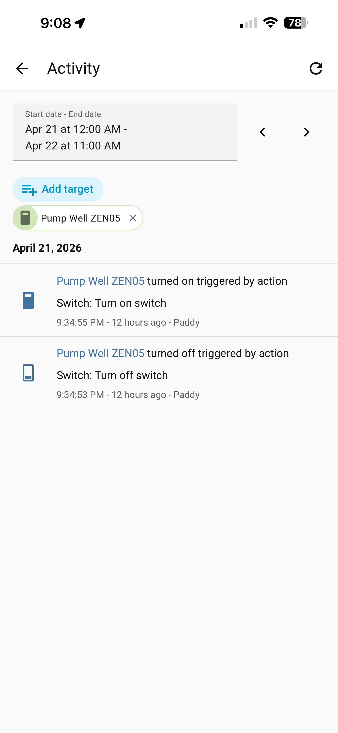

My pump turned on at around 5 am but the history doesn’t show it. Am I missing something?
Time zone related?
The activity log shows your pump switch turned OFF for 2 seconds and has been ON for the remainder of the time in that selected time window.
The graph is showing the 5-minute aggregated power statistics for your pump power sensor.
