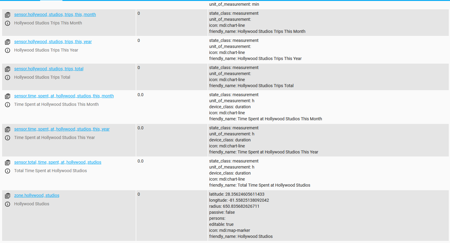

Post a screenshot from Dev tools → State for these history_stats entities which are purged.
Also, are you sure that they are purged? Why do you think so?
Thanks for helping me trouble shoot this. Here is a capture from my Dev Tools screen.
I may be using the word purge wrong, but they are all being reset back to 0 after 7 days.

OK, seems that these sensors have a proper state_class.
But you have not answered this:
Why do you think that there is no LTS permanently stored? Have you tried adding a Statistics graph? Also, a History page will show you an “augmented” history (last 10 days of normal history + LTS for ancient times).
