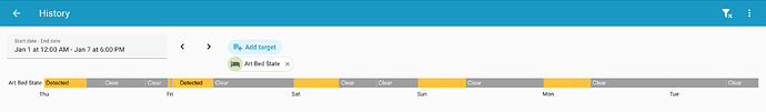

This is the sleep number bed sensor. You can see that I did not record any data last night.

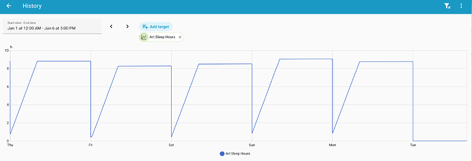

Next is the history stats sensor. Again no data for Tuesday (flat line)

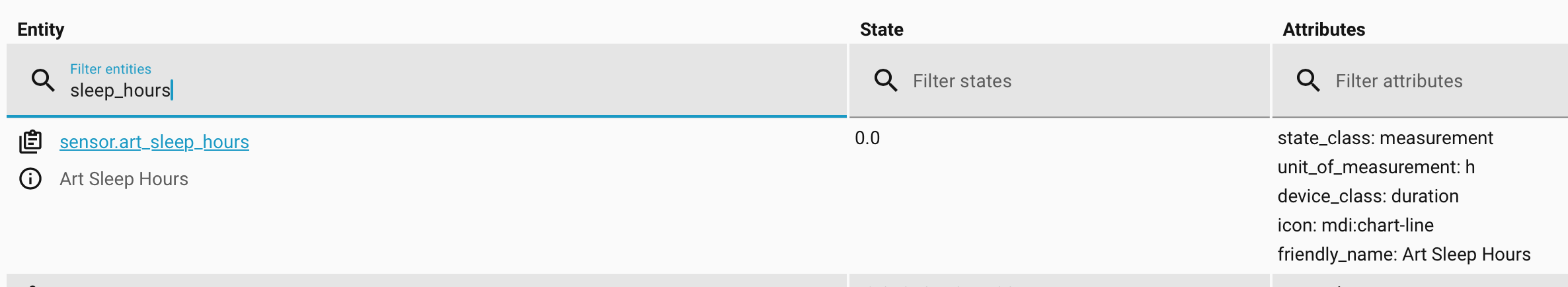

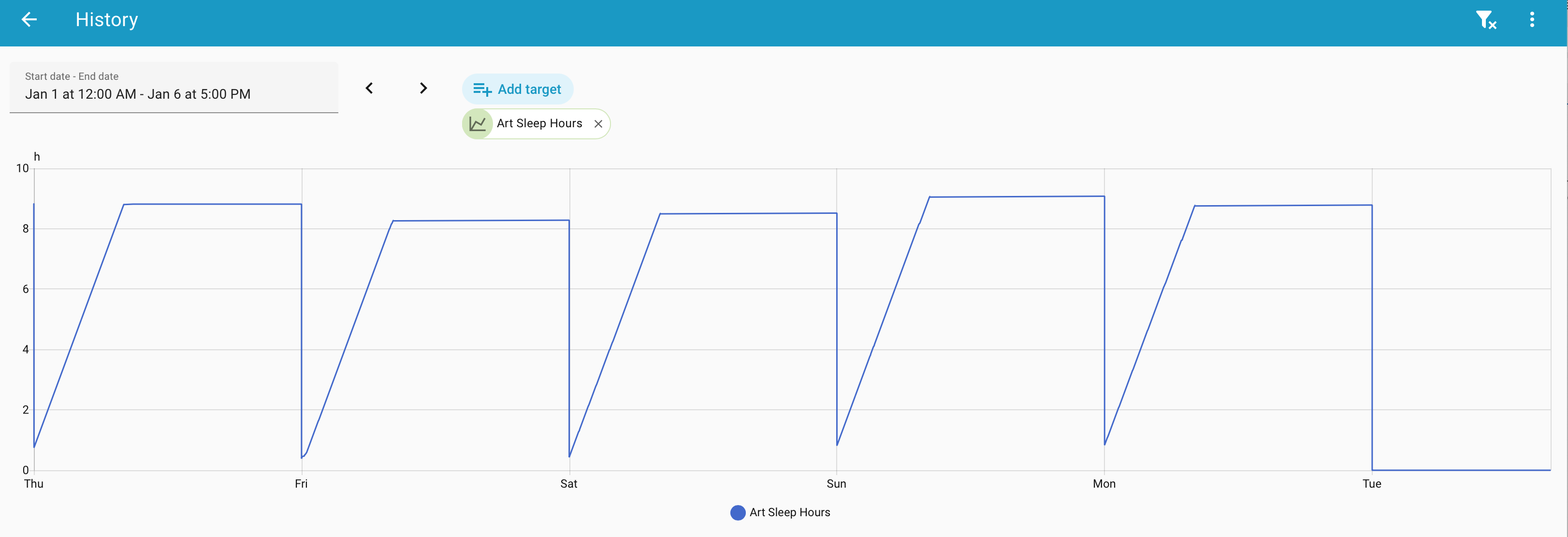

And finally the raw sensor, showing 0 (zero) hours.

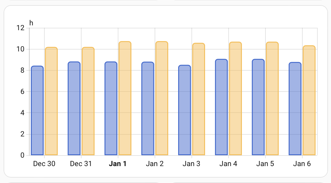

Now for the problem:
My data is blue, wife’s is yellow/orange. Since I did not sleep in my bed WHY do I get data showing I did?

Your card is displaying the max from midnight to midnight and picking up the previous day’s value (history stats only updates once a minute at some random point during the minute so could cross the midnight boundary). This wouldn’t normally be a problem except your history stats sensor is not resetting at the correct time.
This is measuring from midnight to midnight instead of 6pm to 6pm:
Notice when it starts counting and when it resets?
That is not 6pm to 6pm.

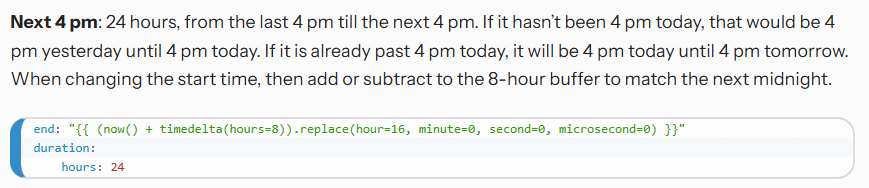

See this example:
https://www.home-assistant.io/integrations/history_stats/#examples
So instead of:
  start: "{{ as_timestamp( now().replace(hour=18).replace(minute=0).replace(second=0) ) - 86400 }}"
  end: "{{ as_timestamp( now().replace(hour=18).replace(minute=0).replace(second=0) ) }}"
you want:
  end: "{{ (now() + timedelta(hours=6)).replace(hour=18, minute=0, second=0, microsecond=0) }}"
  duration:
      hours: 24

Not only that, but notice how in your graph you often tend to have 2 consecutive days with the same bar height. This is because the max for each day is incorrectly showing you the max of the amount you slept yesterday or today.
So if you sleep 8H on monday, 7H on tuesday, and 6H on wednesday it will show 8H for monday, 8H for tuesday, and 7H for wednesday.
This should work as it resets well before midnight (6pm):
