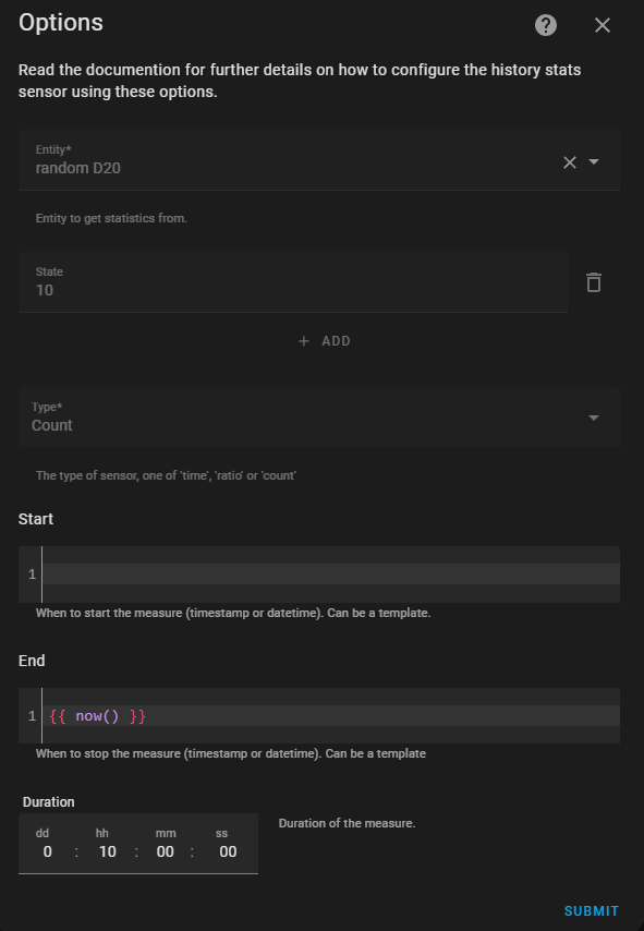

I’m having the same issue when state needs to be corrected and it seems there is no way to do it. What I find interesting is that this problem exists only if you use helper UI and does not exist if you add using configuration yaml
Configured options will be visible in 2025.6
