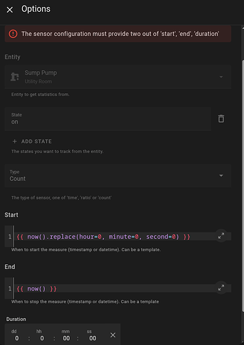

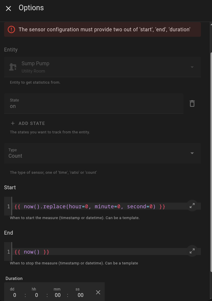

Hi, this is my daily hiostory stat, (no quotes)
Start
{{ now().replace(hour=0, minute=0, second=0) }}
End
{{ now() }}
it doesn’t seem to like it without any quotes.
Click the X on Duration. It doesn’t like that you’re providing all 3 options, you can only do 2.
as karwosts said.

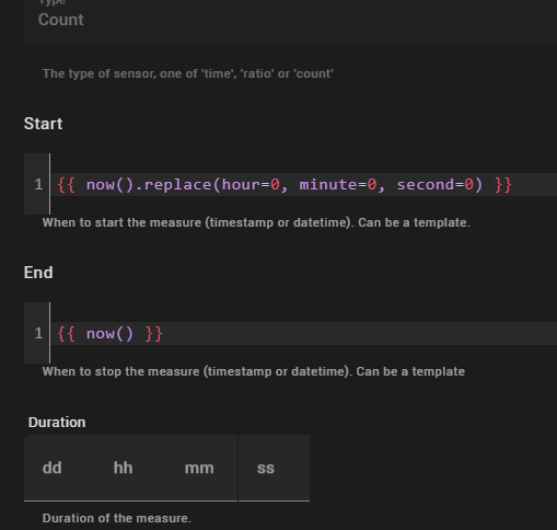

Thank you! Now, I can either use:
start: {{ now().replace(hour=0, minute=0, second=0) }}
end: {{ now() }}
or
duration: 1 day
any reason I’d use one format over the other?
I think they’re basically equivalent.
You can also use:
start: {{ today_at() }}
Is a bit more succinct.
