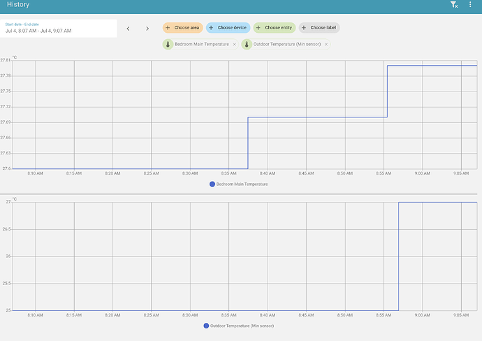

I have a few sensor and they all show together if listed in the history page, but this one shows separate and I can’t quite get why. I tried use the same number of decimals and even the same icon (silly, but it was the last obvious difference that remained at one point).
In the picture, if I added however many temperature sensors to my history selection, they would all show up in the top graph, the combined sensor is the only one singled out.

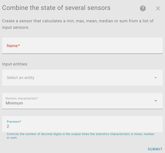

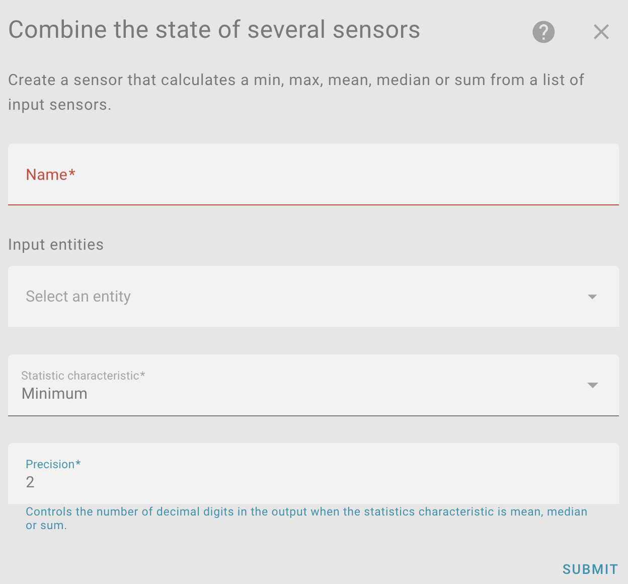

This is the “combine sensors” page where I selected all the sensors.
Check the attributes of the sensors in Developer Tools → States.
Is the combined sensor missing attributes the other sensor has?
Like device_class or state_class?
My Min sensor has these:
state_class: measurement
min_entity_id: sensor. cam1
unit_of_measurement: °C
icon: mdi:thermometer
friendly_name: Outdoor Temperature
the other sensors are not all the same:
  • for some of them temperature is an attribute of another device (camera),
  • for some other devices is the state of the device itself,
    regardless they are grouped together
