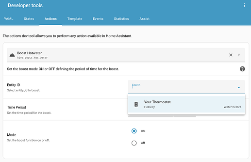

Thanks, I actually found the entity ID automatically in the UI mode. See screen print, I then clicked on YAML mode and it showed:
action: hive.boost_hot_water
  entity_id: water_heater.your_thermostat
  time_period: "00:30:00"
  on_off: "on"
I tried this again, by clicking the Perform Action button - and it worked, the Hive app showed the hot water came on. So I am thinking this is the right instructions…

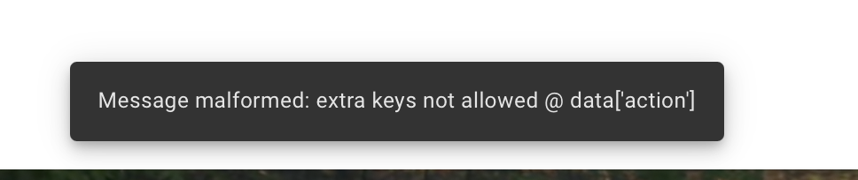

Thanks, when I copy and paste this into a script I get the following error. Any idea why it works in the Developer Tools / Actions menu, but not here (and I used the copy to clipboard button to copy the code across)
can you share the script, verbatim?

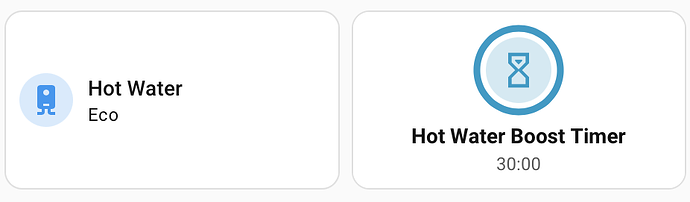

I then have a button linked to the script and timer linked to the timer helper next to the button. Needs a little more work as I would like the button to give a message it is on boost… and am not sure if I can get the button and timer into one card… but getting there!
