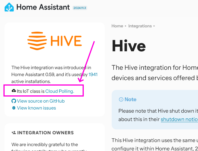

Hmmm. So Hive is only polled every 30 seconds by HA, no doubt this is the reason why as a door is often opened and closed within a few seconds.
:expressionless:
Yeah they don’t have a local public API so it is a cloud polling integration and you can’t smash their servers more often than every 30 seconds.
I realise you probably had this equipment before starting with Home Assistant but in future when purchasing equipment check this part of the integration documantation for local polling (good) or local push (best).
https://www.home-assistant.io/integrations/hive/
You can search core integrations here: Integrations - Home Assistant
