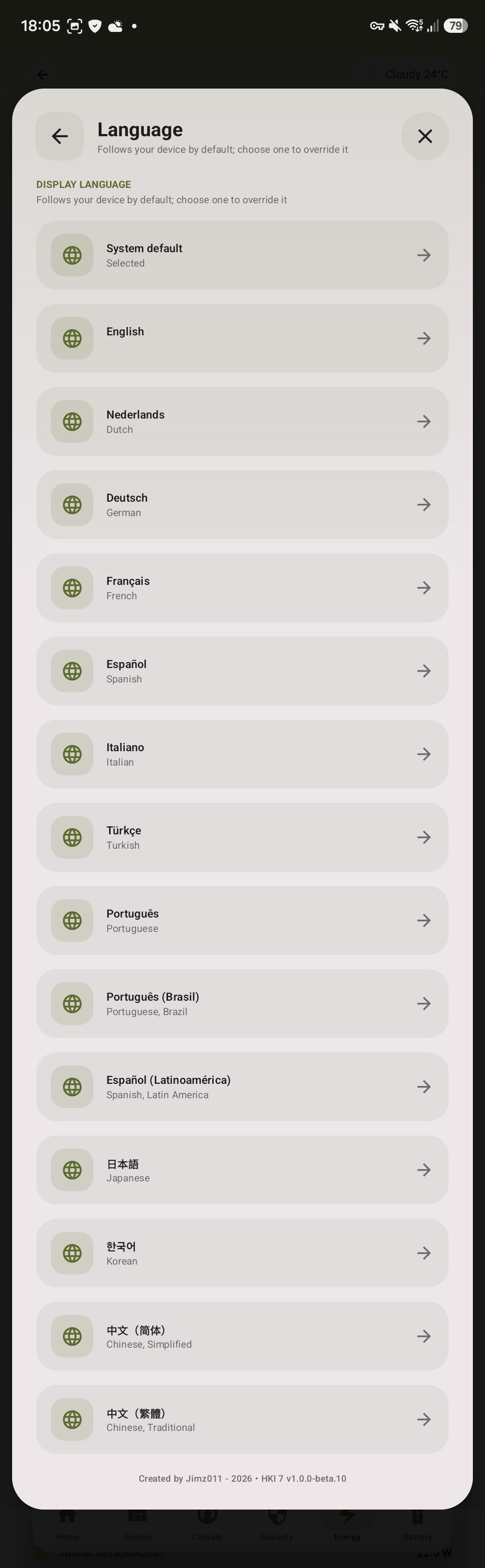

The next beta will contain a bunch of fixes and also translations into the following languages:
  • English (this was already the case)
  • Dutch
  • German
  • Spanish
  • Spanish (Latin America)
  • French
  • Italian
  • Portuguese
  • Brazilian Portuguese
  • Japanese
  • Traditional Chinese
  • Simplified Chinese
  • Turkish
  • Korean
Work done, anyone installing this and is a native speaker I’d love your feedback.
