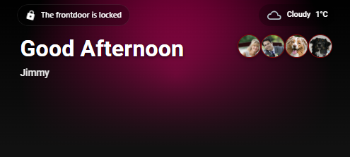

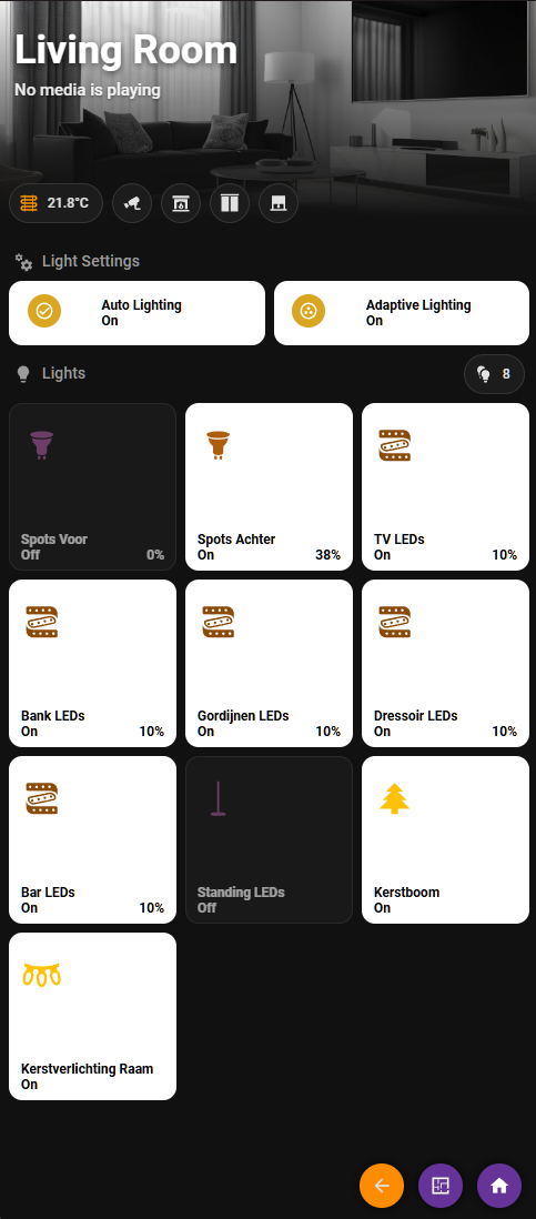

I have made (with help of AI) a card for Home Assistant that gives you the ability to have an actual full width header. I have been looking for something similar but couldn’t really find it so decided to make one that suits my needs.
It is fully configurable via the UI and supports the sections dashboard.
You may also be interested in HKI PostNL Card and HKI Navigation Card
The card does have bugs though, so use with caution :slight_smile: .
Why the name HKI? Well in the past I shared a complete dashboard called Homekit Infused. And for the lack of a better name I simply gave it the same abbreviation, so bite me :joy: . I hope someone will enjoy this card.
Screenshots
Features

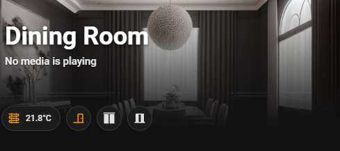

  • :art: Full-width fixed header with customizable background (images, gradients, colors)
  • :iphone: Automatic kiosk mode detection - adjusts position when HA header is hidden
  • :abc: Jinja2 template support for dynamic title and subtitle
  • :dart: Precise positioning controls for title, subtitle, and badges
  • :label: Advanced badge positioning (pinned or scrolling with adjustable offsets)
  • :performing_arts: Gradient overlay with customizable blend
  • :triangular_ruler: Responsive design with adjustable heights

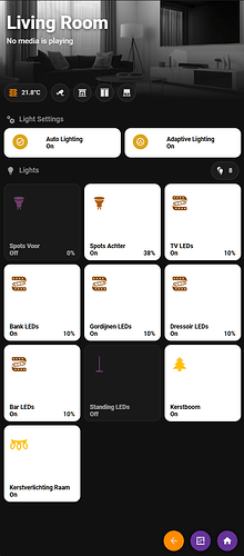

Very nice. How did you add the type of buttons from HKI5 to HKI7, can you share the program? Thank you.
@nikc10 Thanks, well those are just button cards (like in HKI5). The only difference is that they were pre templated for you. However I can share the code.
Just add a grid section on your dashboard, add any card and click on code editor.
Paste this as the first button:
type: custom:button-card
entity: light.garage_2
icon: hue:play-bar-two
color: auto-no-temperature
hold_action:
  action: more-info
double_tap_action:
  action: more-info
show_state: true
show_label: true
label: >-
  [[[ if (typeof(entity) === 'undefined') return; if ('brightness' in
  entity.attributes) { if (entity.attributes && (entity.attributes.brightness <=
  255)) { var bri = Math.round(entity.attributes.brightness / 2.55); return (bri
  ? bri : '0') + '%'; } } ]]]
aspect_ratio: 1/1
styles:
  card:
    - border-radius: 12px
    - opacity: 0.7
  label:
    - font-weight: normal
    - font-size: 12px
    - font-family: Roboto
    - padding: 0px 10px
    - justify-self: start
    - font-weight: bold
  state:
    - font-size: 12px
    - padding: 0px 10px
    - text-transform: capitalize
    - font-weight: bold
  img_cell:
    - align-self: start
    - text-align: start
    - align-items: flex-start
    - justify-content: flex-start
  name:
    - padding: 0px 10px
    - font-weight: bold
    - font-size: 12px
    - color: var(--name-color)
  icon:
    - top: 7%
    - left: 7%
  entity_picture:
    - border-radius: 25%
    - left: 8%
    - top: 10%
  grid:
    - grid-template-areas: "\"i i\" \"area area\" \"n n\" \"s l\""
    - grid-template-rows: 1fr 1fr min-content min-content
state:
  - value: "on"
    styles:
      card:
        - background: white
        - opacity: 1
      icon:
        - color: var(--button-card-light-color)
      name:
        - color: black
      state:
        - color: black
      label:
        - color: black
      lock:
        - color: darkred
Unfortunately button card doesnt support the visual editor, but… you can simply copy each button with the UI copy/paste feature and add buttons to your grid.

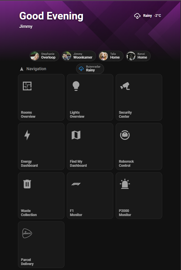

I have recently shared my config for the buttons with you. But I have actually decided to make my own instead. Not as powerful as the custom:button-card (as that is the king of buttons). But at least a lot easier to setup and configure.
Below a little teaser:
oh and even better, it can completely be setup via the UI. No yaml required!

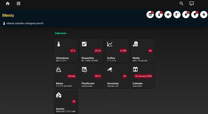

It looks good. Can it be installed? How can I create button submenus?
Yes it can be installed as soon as I release it. The popup is included so no need to fiddle with anything. Just install, select entity and done!
Keep an eye out on these channels, I will announce it once it goes public.
