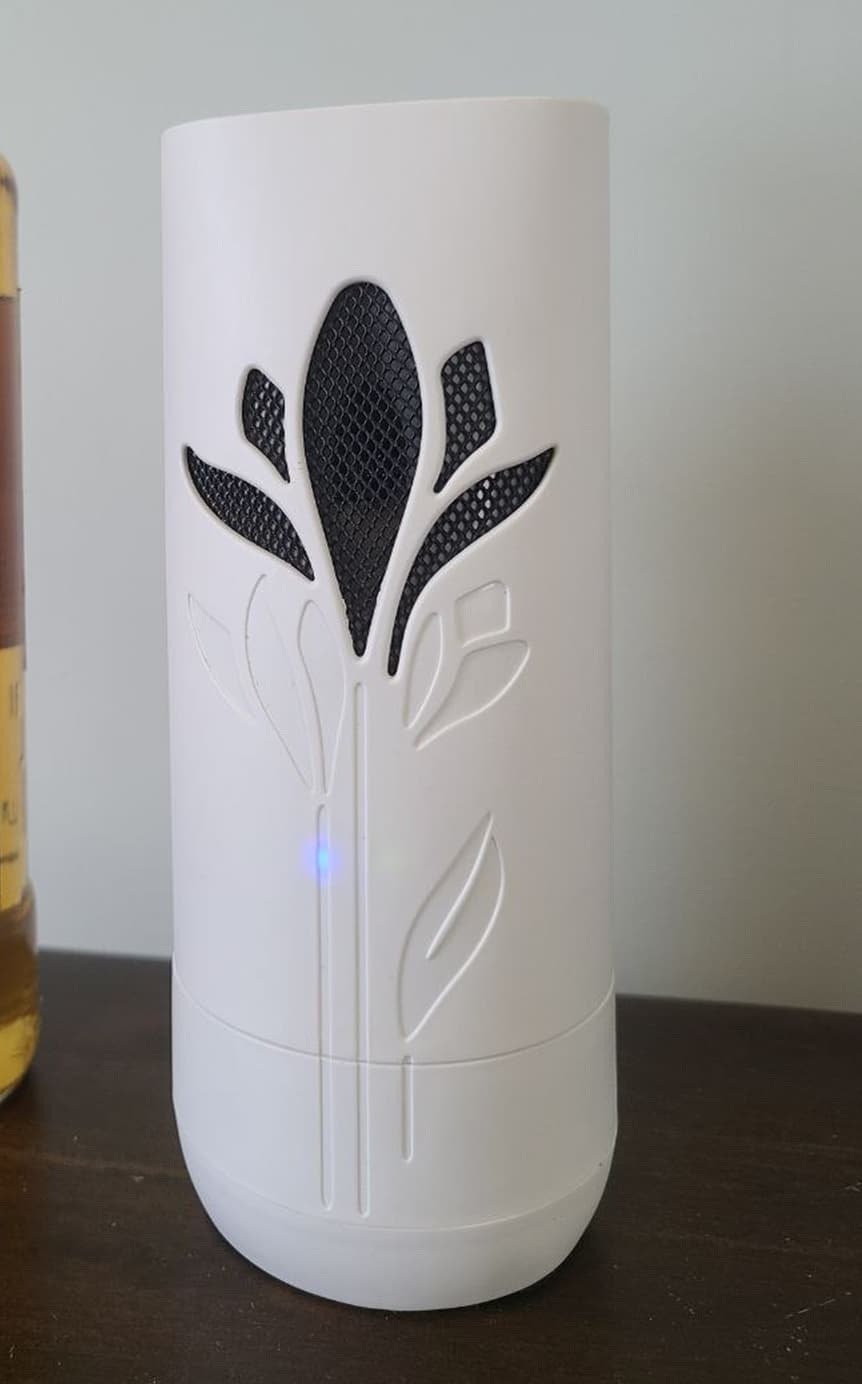

I put mine in a plastic empty air freshner case
