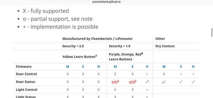

Below is matrix of features. All 1.0 may not show state and it wall panel dependant
Thanks, I’ll try to respond in that thread.

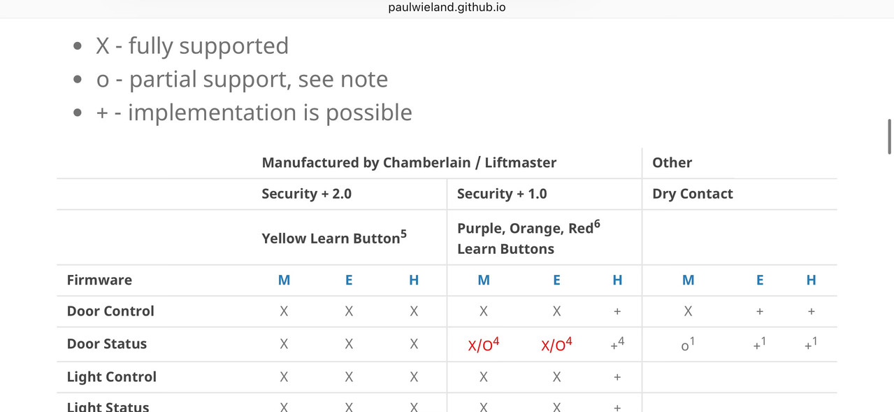

Odd that for my system the door status is fully supported, partially supported, and future supported
Like a schrodinger's cat type deal?
Security 1.0 depends on a compatible wall control which is why it likely shows the X/O status (probably described in footnote #4).

It's in the docs, right where you had found that screenshot: ratgdo
  1. Security + 1.0 openers can report door status over the data line, but not all wall panels are compatible. ratgdo listens for a wall panel to communicate with the door, and if it detects one (such as an 889LM) or 041A7928-3MC it listens and reports the door status. If ratgdo doesn’t hear wall panel communication then it switches to emulation mode, where it streams the query commands necessary to get the door opener status. Emulation mode will cause analog wall panels (e.g. 78LM) to not be able to control the lights or lockout the wireless remotes because their analog commands will be ignored by the door opener.
