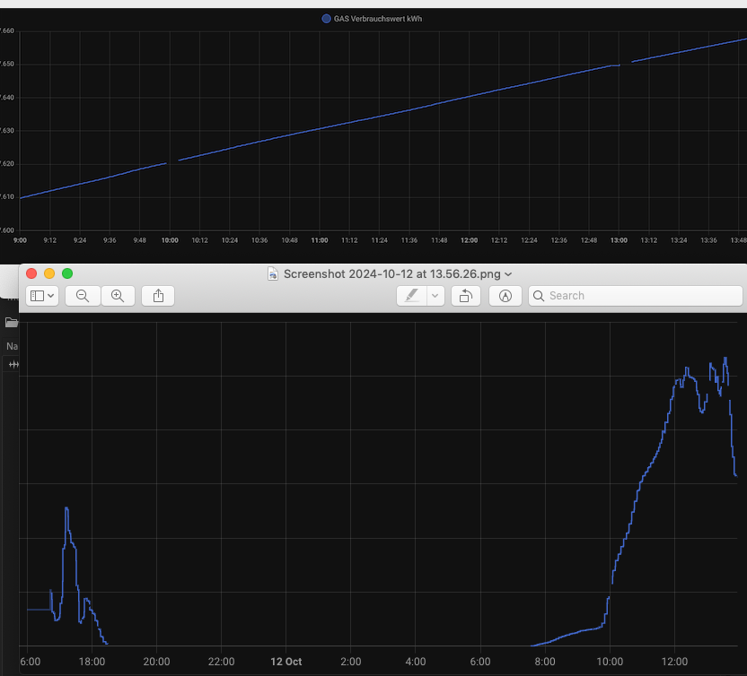

When creating a template from a group of entities, in this case four different solar panels to get a sum of what they produce in power, the graph I am getting is getting holes in it, whenever HA is restarted or the yaml reloaded. I tried the following code, which already helped to not ‘zero’ return in those momets, but now the graph has many holes in it. I
Is it possible to code, that the template returns (and stores for graph display) the last value used until it is available again. I tried ‘availability’ also, but that didn’t work (for me…)
An help appreciated.
here is my template, and an image of the returned graph. I tried two versions, one with ‘is number only’ and one with an if-then logic. both don’t fill the holes…

The “hole” means your sensor was unavailable.
After a restart your template sensor will not have a value until at least one of the sensors it contains updates.
It’s actually nothing to worry about and will not mess anything up. If you want you could create a triggered template sensor. These are restored after a restart.

Thankyou! The code works. I understand, that it’s not necessary, but no holes looks better. :wink:
I do get a nag message in Studio Code Server for - platform: state saying 'String does not match the pattern of “LEGACY_SYNTAX” which seems to be new in version 10.24 and couldn’t correct it (I tried ‘trigger’ instead of 'platform as suggested here: 2024.10: Heading in the right direction - Home Assistant , but somehow it did not compute for me) But, anyways, legacy code does still work and my trigger triggers. So thanks for solving my problem!
