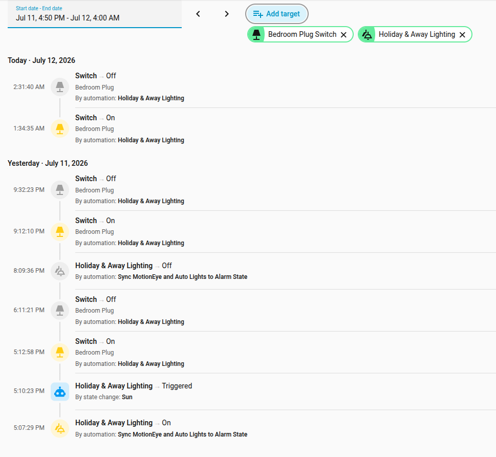

Hello again - I have been using this and it’s working pretty great, but I’ve one issue I’d like to understand how to fix please :slight_smile:
I have my HA setup so that the automation I’ve created from the template is turned on when my house alarm is on, and turns off when my house alarm turns off. So basically if we’re away for the night, random lights will turn on and off which is perfect.
What I’ve noticed though is, even though the automation gets turned off when we arrive home, it seems that left over timer(s) can still fire? I know this because we have a bright light in our master bedroom that is only used for lighting when we’re away, and it popped on this morning at 1:34am heh. Wife wasn’t very happy!
So I’m just curious - when the automation is disabled are there residual timers that keep going? If so, what would be the proper way to stop them, short of restarting home assistant? Or is something else going on?
Here is an image where you can see the automation was disabled, but it still was the cause of the light trigger.

@muppet
Hi Tim, that is not good.
Thanks for providing all the info. What I can see is you don’t have anything stopping the automation. In Automation Control if you select Entity State and in the Entity State input is where you would select your template for when your house alarm is ON or OFF. Then when it is ON the automation will be active but when it is OFF the automation will be disabled.
BUT!
I have just tested it and can see that if it was started when you were out and then came home turning OFF your alarm it would still run until the end. This is a bug I will need to resolve… it will be fixed in the next release that will be out soon.
Blacky :smiley:
The way I do this is I have the following automation, which itself enables and disables the Holiday & Away Lighting Automation.
YAML:
alias: Sync MotionEye and Auto Lights to Alarm State
description: ""
triggers:
  - trigger: state
    entity_id:
      - alarm_control_panel.home
    to:
      - disarmed
      - armed_away
conditions: []
actions:
  - if:
      - condition: state
        entity_id: alarm_control_panel.home
        state: armed_away
    then:
      - action: homeassistant.enable_config_entry
          config_entry_id: 19c055be2b26e2dc23ad1ce4f0a10fec
      - action: automation.turn_on
        metadata: {}
          entity_id: automation.holiday_away_lighting
        data: {}
    else:
      - action: homeassistant.disable_config_entry
      - action: automation.turn_off
        metadata: {}
          stop_actions: false.  <------- I think this should be true!
mode: single
I did it like this because I couldn’t see a way to use the state of armed_away of my alarm (which is a custom addon, alarmo) within the automation control → entity state and I didn’t want to create a boolean_value if I didn’t need to. Plus this automation already existed to turn the MotionEye addon on and off so dropping Holiday & Away Lighting Automation in seemed a natural fit.
What I have noticed though is that stop_actions: false which almost certainly I should have set to true. So it’s probably my fault for not setting that correctly - the automation was allowed to continue.
Anyway thank you very much for your prompt reply and I’m glad you’ve also found something to fix, so it’s win win all around.
