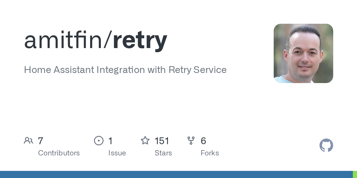

FWIW, anything that I want to work reliably - issue the command, if the state didn’t change, retry the command with a delay, and do that up to 3 times, then generate an alert.
I did this through a set of scripts. There’s now a custom component that does it.
