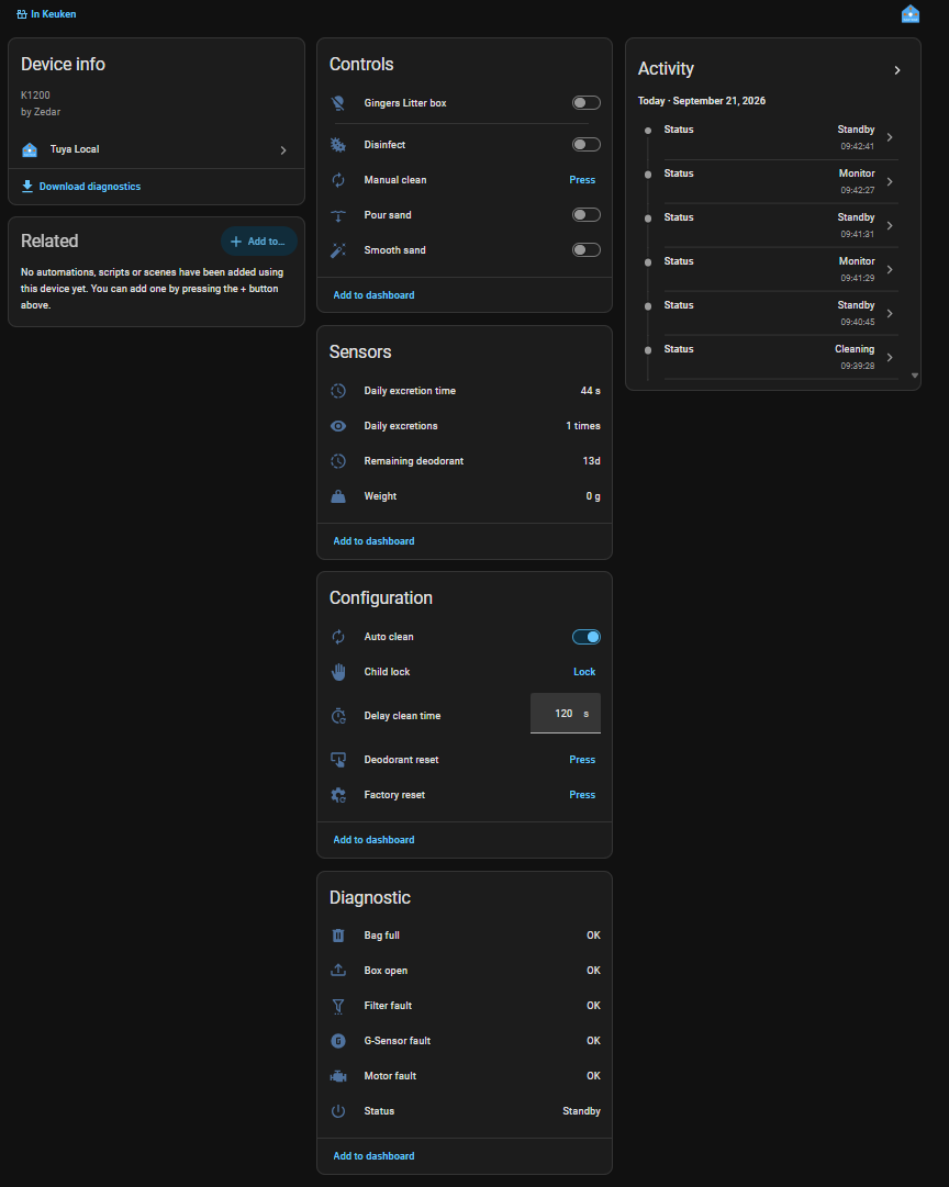

I have installed Tuyo Local (3.5 support)
I could choose a Device (zedar_k1200_litterbox) that seems to match my Hombli litterbox …
The only weirdt thing is that DP6 never changes, it stays 0 …

Hi @xBigGx,
I ran into the exact same issue with my litter box using the zedar_k1200_litterbox profile where DP 6 stayed permanently locked at 0.
With the help of an AI assistant, I dug into the raw data packets from the Tuya Developer IoT Platform logs, reversed the binary payload, and unmasked why this happens. Here is the technical breakdown and a fully working local fix.
The Problem
The manufacturer does not write numeric weight values directly to the standard Tuya schema data point (cat_weight / DP 6). Instead, they use a hidden, custom telemetry property called work_record (DP 104), which transmits a dynamic, Base64-encoded text string payload (e.g., GgoBFQYmAw88).
The standard integration profile completely misses DP 104, and because it is an encoded text string rather than a clean number, Home Assistant ignores it. Depending on the event (Cat entered vs. Cat left vs. Cleaning), the length of the string bytes shifts. An Event Type 3 packet signifies an active mass measurement step, where the final two bytes hold the actual weight integer in high/low byte format.
With the help of AI, we managed to write a custom Jinja template that decodes this Base64 stream using standard arithmetic (avoiding the bitwise operators that the native HA Jinja engine doesn’t support by default).
Step 1: Add the Raw Sensor to your YAML
To make this text payload appear locally in Home Assistant, you need to append DP 104 to your local tuya-local configuration file.
Open your config/custom_components/tuya_local/devices/zedar_k1200_litterbox.yaml file and add this block at the very bottom of your entities:

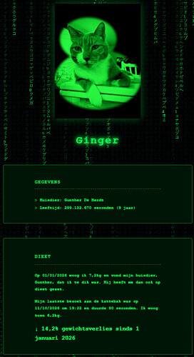

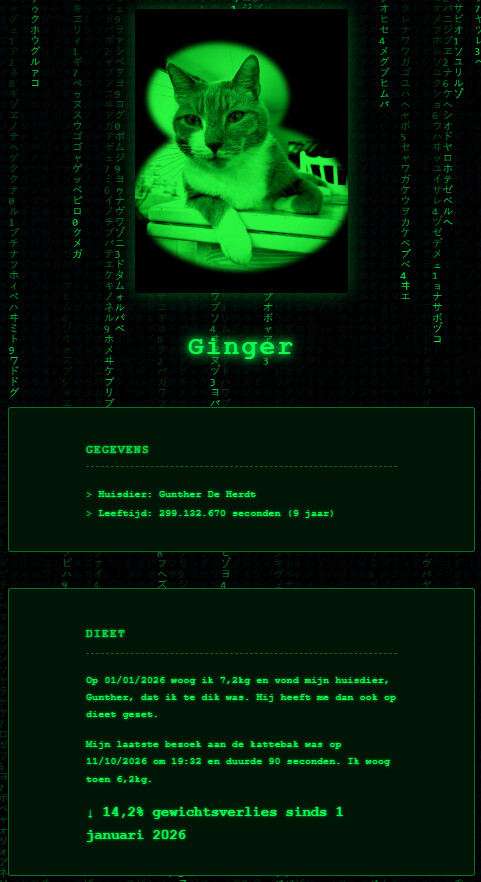

Thx alot! Got it working to on DP 104 with the help of some AI also!!
Thx for sharing!!
I can now expose this data on my totaly useless website :tada: (If you understand dutch)
