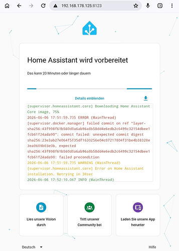

The problem is as follows: I installed HA 17.3 onto the NVMe SSD using the Imager and inserted it into the Raspberry Pi 5. HA boots up and indicates that everything is fine.
When I access http://homeassistant.local:8123/ (or ip:8123), the installation process begins. Everything works at first, but then an error occurs:
ERROR (MainThread) [supervisor.docker.manager] failed commit on ref "layer-sha256:43f998f61b560d0a6ab96a8b58dd4e6edb2c6499c32154dbee1fcb61f24ada90": commit failed: unexpected commit digest sha256:23e3ab27e064f5f35df1630256e04c07217804f31be4b38328e3ea0609b03e0b, expected sha256:43f998f61b560d0a6ab96a8b58dd4e6edb2c6499c32154dbee1fcb61f24ada90: failed precondition.
WARNING (MainThread) [supervisor.homeassistant.core] Error on Home Assistant installation. Retrying in 30sec. The error then enters an infinite loop and repeats continuously.

There was a thing for a while that PI5's that did not have the internal firmware up to date were having problems installing HA. Make sure the Pi itself's internal eeprom is the latest.
after checking the firmware, i'd also disable the wifi (via the second option in link) Disabling Wifi on Raspberry Pi - Installation / Home Assistant OS - Home Assistant Community
Hello, I have same problem with installation on Virtualbox. The problem appears to be with the file signature. It expects a certain SHA256 and receives a different one, thus blocking the installation. Does anyone know how to fix this? I've run all the network checks, and they've all been successful.
