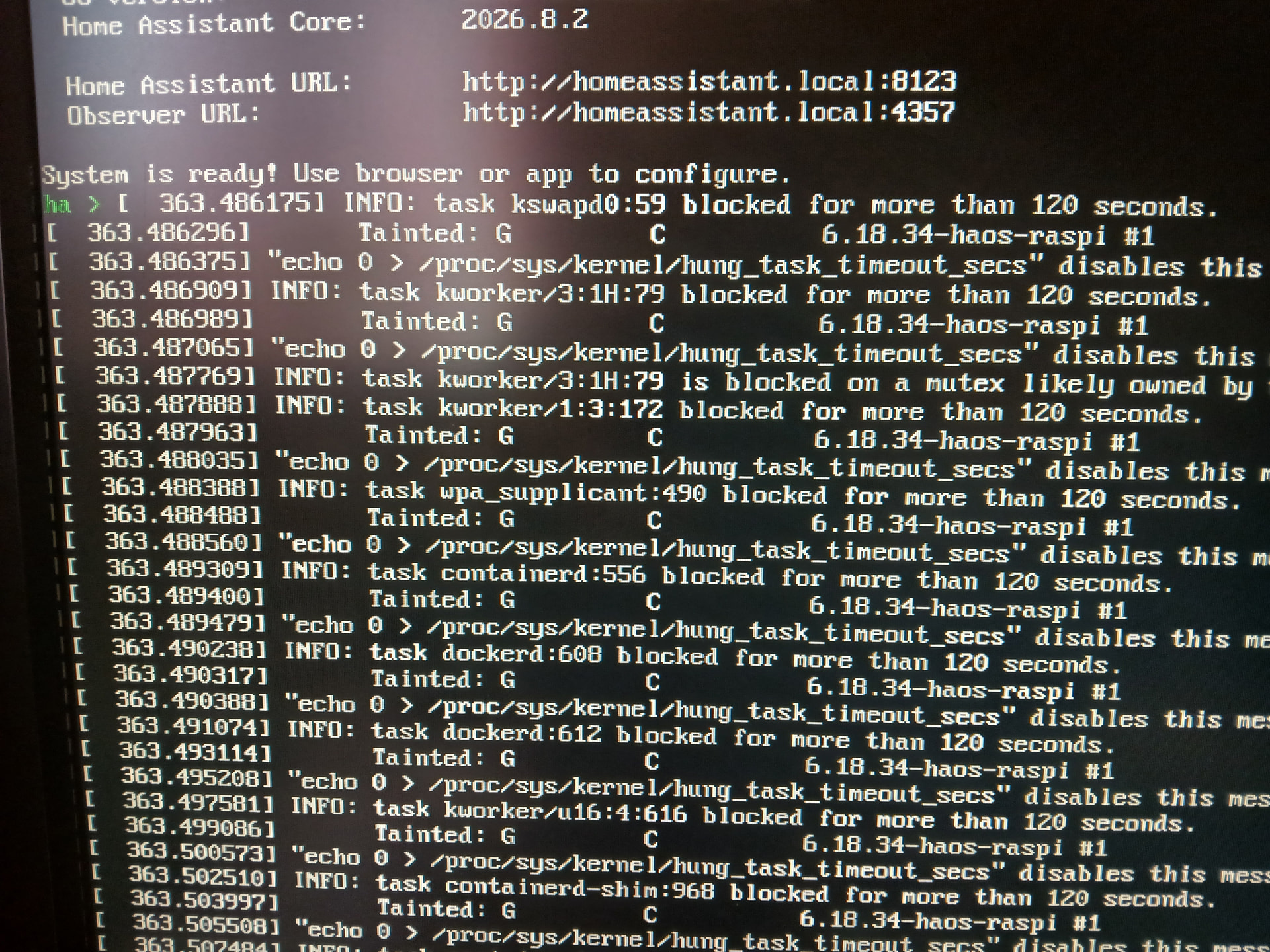

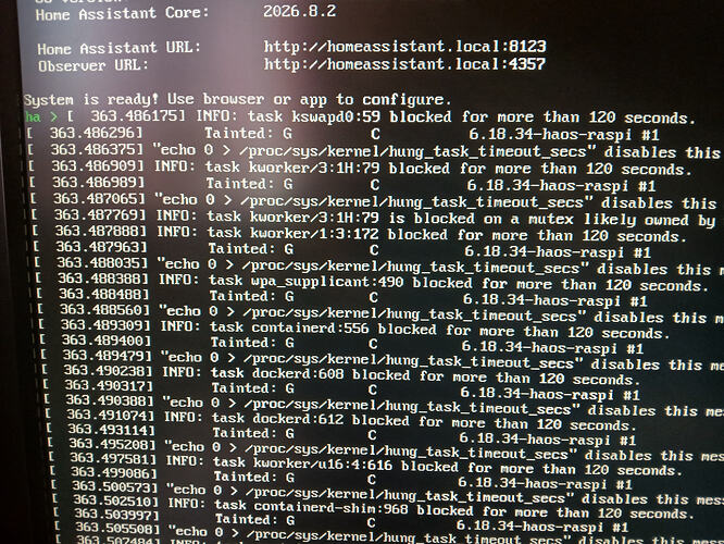

In any case, this is what it looks like:
Is it possible to restore the existing installation, or is it better to do a fresh install of HA?
You can gain little more memory by disable the head(gpu/display) if you running headless.
Home Assistant will make a backup, if you didn’t disable that.
So if you could grab that backup file to some another computer, you could start from fresh and restore the backup.
Or you may have the sd card taken out from the pi, and mount that to a Linux System, and then take the backup files from there. If you want to start fresh with some backup.

I had forgotten that Node-RED and SAMBA were also installed; I’ve now uninstalled them, and the Pi 3 is using 60% of its RAM and 6% of its CPU.
I’ll probably upgrade to a Pi 4 if the price is right.
I haven’t had to restart anything in a while, so I think it’s stable right now.
For now, it feels like the “issue” is resolved.

If I hadn’t had the monitor connected during this troubleshooting session, I wouldn’t have seen all the lines in the image I showed a little earlier, nor would I have noticed that they restarted on their own after a while.

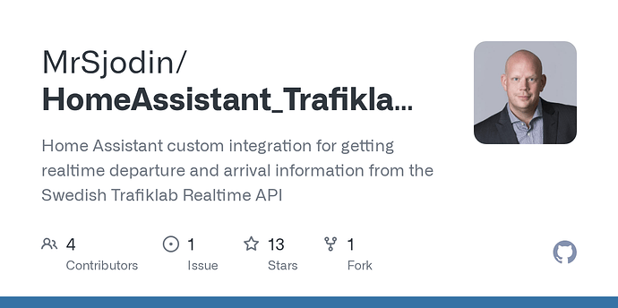

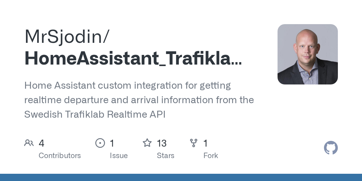

This was the feature I wanted to add:
But to make that work, I apparently needed HACS, which led to this forum thread.
