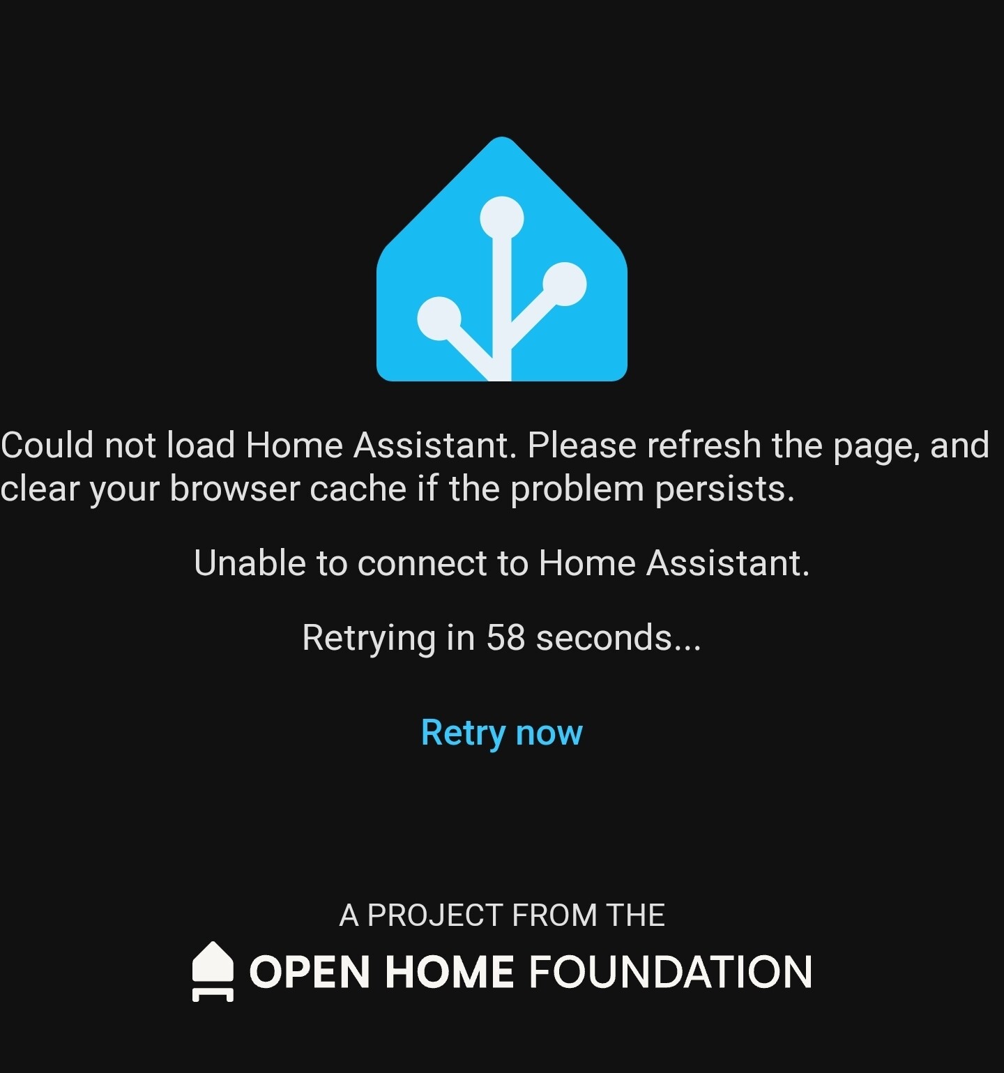

After updating to Home Assistant 2026.9.0, I started experiencing a connection issue both in the Companion App and when accessing Home Assistant through a web browser.
I repeatedly got the following message:
Could not load Home Assistant. Please refresh the page, and clear your browser cache if the problem persists.
Unable to connect to Home Assistant.
Retrying in XX seconds…
I tried several troubleshooting steps, including clearing the browser cache and browsing data, clearing the Companion App data, and completely uninstalling and reinstalling the Companion App. However, the problem persisted.
Sometimes I was able to reach the Home Assistant login page, but after logging in, the same error would appear again. After refreshing the page several times, I could occasionally get into Home Assistant, but the issue would return.
The only solution that worked was restoring a backup from Home Assistant 2026.8.3. After restoring the 2026.8.3 backup, the problem disappeared completely, both in the Companion App and in the web browser.
