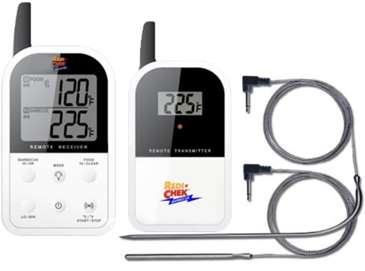

I have an old Maverick Redi-Chek ET-732 thermometer which came with both meat and BBQ probe:
It reads temps on the BBQ probe up to 572°F.
