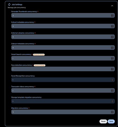

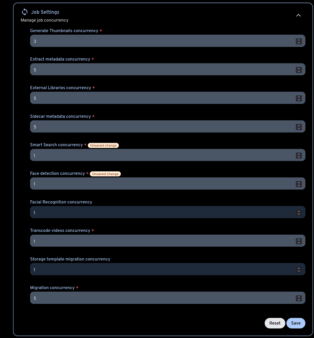

Asking because in the ‘default out of the box’ configuration i’m getting a lot of the following errors on an Intel N150 running HAOS baremetal, so I disabled the machine learning feature. It looks like it is missing the ML models in the addon?
[Nest] 279  - 07/27/2025, 12:54:31 AM    WARN [Microservices:MachineLearningRepository] Machine learning request to "http://127.0.0.1:3003" failed: fetch failed
[Nest] 279  - 07/27/2025, 12:54:31 AM   ERROR [Microservices:{"source":"upload","id":"787redacted88f"}] Unable to run job handler (AssetDetectFaces): Error: Machine learning request '{"facial-recognition":{"detection":{"modelName":"buffalo_l","options":{"minScore":0.7}},"recognition":{"modelName":"buffalo_l"}}}' failed for all URLs
[Nest] 279  - 07/27/2025, 12:55:25 AM    WARN [Microservices:MachineLearningRepository] Machine learning request to "http://127.0.0.1:3003" failed: fetch failed
[Nest] 279  - 07/27/2025, 12:55:25 AM   ERROR [Microservices:{"source":"upload","id":"c53redacted27"}] Unable to run job handler (SmartSearch): Error: Machine learning request '{"clip":{"visual":{"modelName":"ViT-B-32__openai"}}}' failed for all URLs
EDIT: Seems like after some hours and a restart of the addon now, at least the face detection/buffalo is working.
