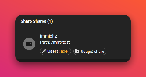

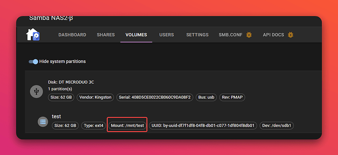

Instead of using the option to mount localdisks (which makes the drive only accessible to the single add-on), I have found another add-on called Samba NAS2, which is an alternative Samba add-on to the official. This one is able to mount a USB drive, AND share it over Samba quite easily (and without crazy udev methods). This makes it accessible to any add-on.
I personally made it accessible inside the “Share” folder as well.
So then I was able to use Immich just setting the data_location as /share/immich2, without doing using your localdisks option at all.

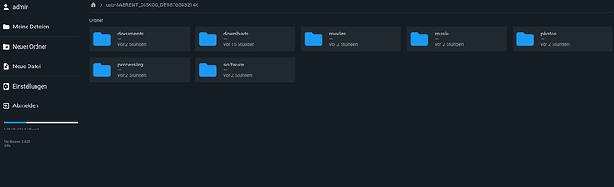

Hi, I have a filebrowser installed in HA but I can only use 11.6 GB of my 2 TB?
fromat is ext 4
