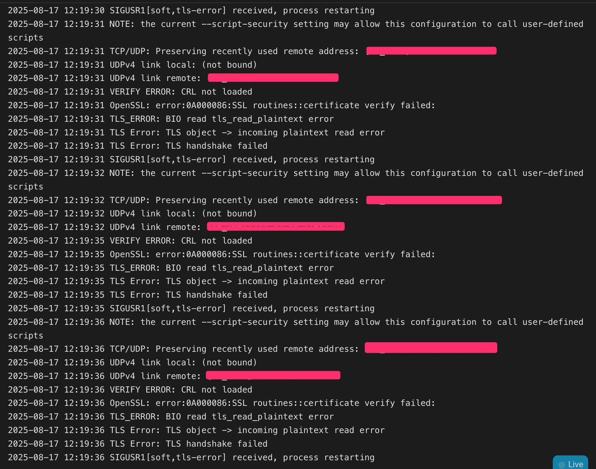

I’ve spent hours working on this on my own to try and avoid posting here and asking, but at this point I’m just doing the same things over and over with no change. I’m very new to HA OS and any sort of coding in general, so I’m hoping this is going to be a stupidly simple issue.
I’ve set qBittorrent up and it works great witihout any VPN settings, but when I try and connect through PIA I cannot successfully set it up to where it launches. Here is the error message I keep stumbling on when attempting to start the add-on with OpenVPN enabled:
WARNING: ca-toronto.privacy.network is referenced in your ovpn file but does not exist, and can’t be found either in the /config/openvpn/ directory
As best I can tell, rather than recognizing ca-toronto.privacy.network as an endpoint hostname, it’s reading it as a file name that it cannot locate on my RPi. I’m at a loss as to what to do now.
Here is the relevant part of my .opvn file:

-----BEGIN X509 CRL-----
Hi, indeed it thinks it is a filename. However it should not be a blocking point, it is only a warning : hassio-addons/qbittorrent/rootfs/etc/cont-init.d/93-openvpn.sh at master Ā· alexbelgium/hassio-addons
I’ve pushed a new version please try it at least it won’t show the error message. Btw have you tried transmission? I think it works out of the box with PIA (never tried myself).
Thank you for the reply. I’ve updated to your new version, and while the prior warning isn’t showing up anymore, it’s now in an endless loop. I took a screenshot of the log. Basically every 5 or so seconds it appears to be trying a new IP address and then fails and moves to a new IP address 5 seconds later. Does that cycle for about a minute, then qBittorrent restarts and the process of trying different IP addresses resumes.
I haven’t tried Transmission, but I can definitely give it a look. Your add-on was just the first that came up when I was searching.
And now I start wondering if some people didn’t have issues because Pia doesn’t support openvpn v3… I think it was already quite hard for people in the past to use Pia…
So it sounds like I’m not going to get this to work because of a PIA limitation? If that’s the case I will begin investigating Transmission as you had suggested. Thank you so much for your replies and help. Sorry to have bothered you.
I think some people have better luck with the transmission_openvpn in my repo . But looking in my issues log it seems some people had a solution : šŸ› [qbittorrent] Since last update no longer starts up Ā· Issue #1351 Ā· alexbelgium/hassio-addons Ā· GitHub by Ā« removing the crl-verify block Ā»
Yup, that fixed it! Thank you for the suggestion.

Hi everyone!
I’ve been trying to upgrade my config to use WireGuard and after a couple hours iterating with ChatGPT (which originally helped me set all of this up), I’m now desperate and resort to asking for help here.
Here’s what I’ve tried:
Steps:
  1. Placed a valid Surfshark WireGuard config in
/addon_configs/db21ed7f_qbittorrent/wireguard/wg0.conf
  1. Enabled:
wireguard_enabled: true
wireguard_config: wg0.conf
openvpn_enabled: false
  1. Cold-started the add-on.
Resulting log:
FATAL: WireGuard start failed.
Starting WireGuard interface wg0...
Retrying WireGuard using iptables-legacy wrappers.
Initial WireGuard connection failed. Trying IPv4-only endpoints.
ERROR: WireGuard failed to establish connection.
ERROR: [#] ip link add dev wg0-ipv4 type wireguard
Has anyone been able to successfully make this work with Surfshark?
Thanks in advance, have a great day!
I am having completely same issue with the Proton wireguard VPN - placed valid config into wg.conf, referenced in the addon configuration, but WG fails during startup:
[17:25:49] FATAL: WireGuard start failed.
[17:25:50] INFO: Starting WireGuard interface wg0...
[17:25:51] WARNING: Retrying WireGuard using iptables-legacy wrappers.
[17:25:51] WARNING: Initial WireGuard connection failed. Trying IPv4-only endpoints.
[17:25:52] ERROR: WireGuard failed to establish connection.
[17:25:52] ERROR: [#] ip link add dev wg0-ipv4 type wireguard
[#] wg setconf wg0-ipv4 /dev/fd/63
@alexbelgium Can I provide any more detailed information so this can be solved?
The issue seems to be already well reported a month ago. @alexbelgium would it be please possible to implement it? I can test any beta you release. Thank you.
I was able to pinpoint and fix issue with the wireguard (and consequently qbittorent) not starting and I created PR with the fix. Now it is on Alex to merge it.
Thanks merged!
