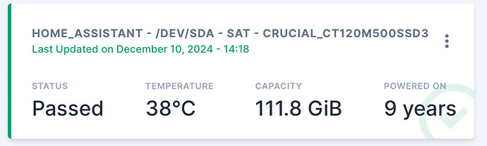

Hard to believe my HA has been running this long…. Maybe I should swap that ssd out?
Ssd are pretty resilient! But for sure having a regular backup of the data wouldn’t hurt :wink: I’ve set an add-on to automatically reboot and rsync the content from one disk to another to be sure to have regular external hdd backups

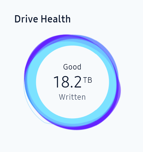

Anyway to see total written data to the SSD? similar to what Samsung Magician app provides
Hi, scrutiny gives the info of sectors written! You then need to convert it in terms of bytes based on the format type of your drive. I saw some formulas for that on internet… But there is no direct smart value for that I guess the Samsung app just does the calculation by itself!

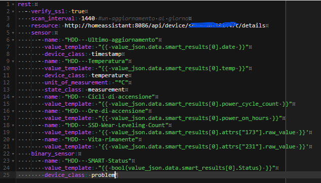

Hi, I just reset my HA due to some issue and I restart from 0 all instalaltion, in this stage unfortunatelly I have and issue with scrutiny and I resolve it install the full access without the protection mode. Now the issue is to take the data from the SSD, because use the links:
I cannot reach the data and consequently I cannot use “rest” integration…somebody how the same issue???
Here below a screenshot of the “rest” code
Any help would be appreciated…
