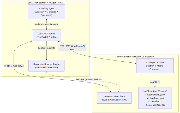

Architecture & Safety Highlights
  • Lightweight Host Footprint: The Add-on is a standalone Python FastAPI daemon (< 50MB RAM, zero idle CPU) compiled for linux/arm64 and linux/amd64.
  • Path Traversal Jail: File operations are strictly locked to /config / /homeassistant.
  • Protected Secrets: Access to secrets.yaml, .storage/core.auth, SSH keys, and certificates is denied at the API boundary (403 Forbidden).
  • Atomic Pre-Edit Snapshots: Every write operation automatically creates a timestamped backup in /config/.snapshots/ before writing to disk, with 1-click rollback support.
  • Client-Side Playwright Rendering: Screenshots for visual feedback are rendered on your local workstation where the MCP client runs, offloading all browser rendering load from the HA machine.
  • Log Redaction: Automatic regex filtering redacts API keys, long-lived tokens, and passwords from log tails.

The MCP + HA space is filling up fast, so the design question worth getting right early is differentiation at the identity layer, not just the action layer.
A pattern some teams are exploring is treating the AI agent itself as a named principal in the HA permission model, so automations can be scoped per agent rather than per token. If you have multiple agents hitting the same MCP server (a voice assistant, a scheduled routine, a debug session), HA logs can show which agent did what, and you can revoke or sandbox one without affecting the others.
For ha-ai specifically, I’d ask whether the server passes agent identity context through to HA today, or whether it’s effectively a shared credential. That single design call opens a lot of UX surface later: per-agent scenes, audit trails, guest agent access.
Interesting idea.
I built this MCP with end-to-end Lovelace dashboard building and automation debugging in mind. It uses a long-lived access token for Home Assistant’s REST/WS APIs, and a read-write config mount in the companion app for configuration and dashboard editing.
So effectively, it uses shared credentials, and Home Assistant itself doesn’t distinguish which sub-agent triggered a specific service call (though the app does create timestamped snapshot backups before every file edit).
You gave me some good food for thought, thanks!
