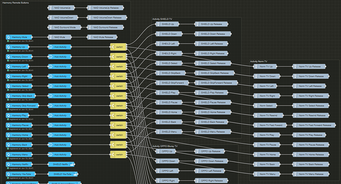

I use NodeRED to control my Harmony Hub Not Only Activities but Device Buttons as Well.

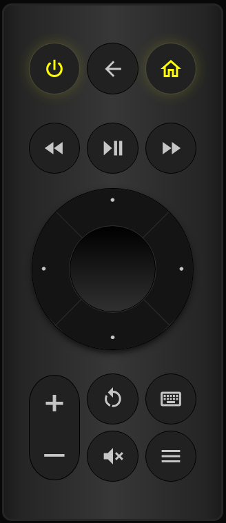

Firemote Card Configuration
  • Uses media_player.shield_debug_bridge for the following
    • Back
    • Home
    • Play Controls
    • Power Active Status
Firemote Button Overides
  • Uses Logitech Harmony Hub Integration for the following
    • Power Button - Toggles the On Off of the Harmony Hub
  • Uses NodeRED Flow to activate Device Buttons
    • Mute Button - Activates the Mute Switch on my NAD Amplifier
    • Button Press - Activates Device Buttons through Node Red
Firemote Yaml
  - type: custom:firemote-card
    entity: media_player.shield_debug_bridge
    device_family: nvidia-shield
    device_type: shield-tv-pro-2019
    compatibility_mode: default
    android_tv_remote_entity: ""
    defaultRemoteStyle_override: AL2
    app_launcher_relative_size: 0
    button_overrides:
      mute-button:
        service: switch.toggle
          entity_id: switch.nad_mute_switch
      power-button:
        service: remote.toggle
          entity_id: remote.harmony_hub
      left-button:
        service: button.press
          entity_id: button.harmony_left
      right-button:
          entity_id: button.harmony_right
      up-button:
          entity_id: button.harmony_up
      down-button:
          entity_id: button.harmony_down
      center-button:
          entity_id: button.harmony_select
      volume-down-button:
          entity_id: button.harmony_volumedown
      volume-up-button:
          entity_id: button.harmony_volumeup
      keyboard-button:
          entity_id: button.harmony_surroundmode
    scale: "99"
    hide_button_group_frame: true
    dpad_style: apple-tv-black
NodeRED Flow
The Button Press entities mentioned above are generated in NodeRED.
The Flow detects what Harmony Activity is Active and then will Re-Map the button Press to the right device.Harmony Hub Button Mapper & Home Assistant
