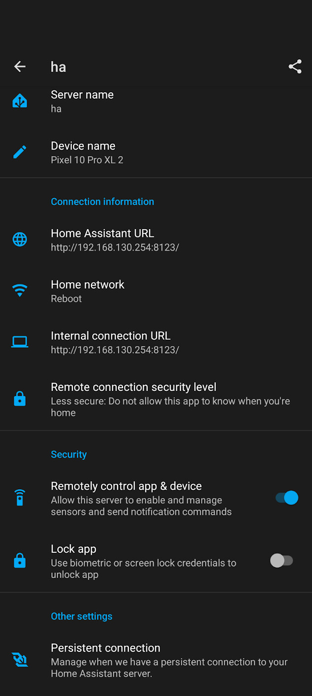

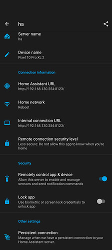

Below is the server setup, notice the HTTP.
In the HA configuration.yaml I have an internal URL and no external URL, and the internal URL is identical (and without http).

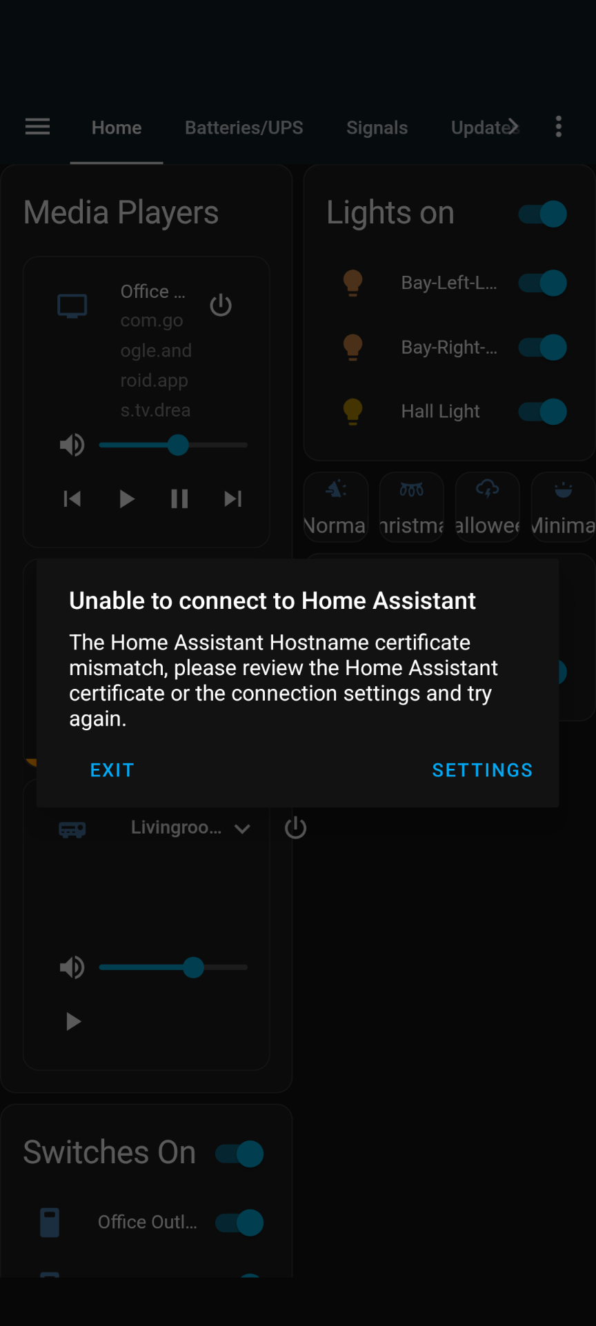

Arggg… almost as though it was reading my posts, yesterday for about 2 hours it just continually gave the errors again. Example below.
I can just hit “settings”, then exit from settings (no change) and it would work, until the next time I started the app.
WHAT CERTIFICATE? I’m not using any certificates (or https) overtly so what is not matching? It’s so silly it gives an ALMOST useful message, but no details, no longs (that I know of?), nothing.
Sigh… anyone know… WHAT CERTIFICATE does it use?

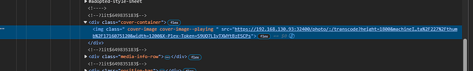

The error is originating when the google cast integration’s media player is trying to display a cover image from plex.
On my network nothing uses https, including plex, it’s all http and all local subnet not remote.
When the media player tries to get a cover image (presumably from a url somehow derived from the plex server’s connection to the google TV 4k Streamer), it gets a https url. The actual connection is http (or it wouldn’t work). Something is changing the cover image (only) to https:
That URL is the plex server not the HA server. This is from a browser viewed in debug, the browser ignores the error showing a no-image image.
Instead of just ignoring the error Home Assistant companion is showing the modal error popup. Which is fine (if overkill), the real error is the https itself.
