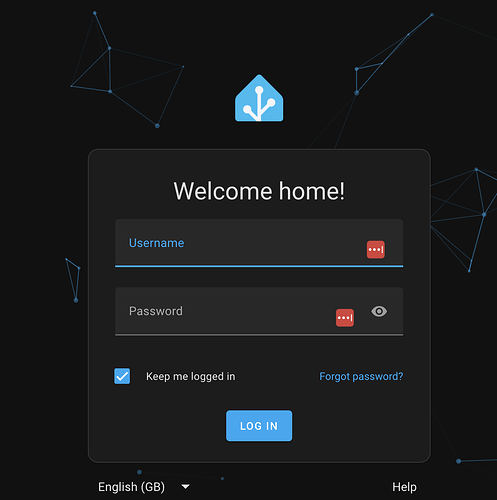

for reference the HA login page when accessed through the internal network address looks like this:
as a new contributor I can only post 1 media per post

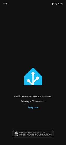

I have been running this setup for like 6 months without issues, except with separate docker container instead of the addon. Sometimes when I launch the app, it looks like this.
But after using the retry option, it works fine again. This happends like once a day or so. Any ideas? Maybe some timeout or something?

For anyone having sporadic issues, make sure that HTTP/3 is disabled. I followed the guide and couldn’t get it to ask me consistently on my phone until I disabled that.
Its moved around a bit but its (your domain) > Speed > Settings > Protocol Optimization
Thank you so much for this important hint! Now it works for me.
Huh, I think this actually helped! Thanks!
